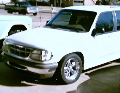

FYI- i havent had a day off in the last 12 days (12 hour shifts). thats 144 hrs in 2 weeks, or about 72hrs a week. i said no webcam pics, but i know you guys are dying so here you go.
this is the last night i work, and then im off all weekend. i PROMISE i will have pics this weekend.
-4"

OMG drool. Looks so badass James. Did you get the blocks in as well?
