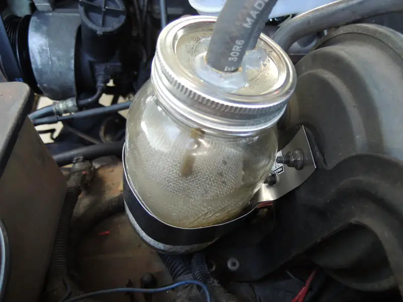

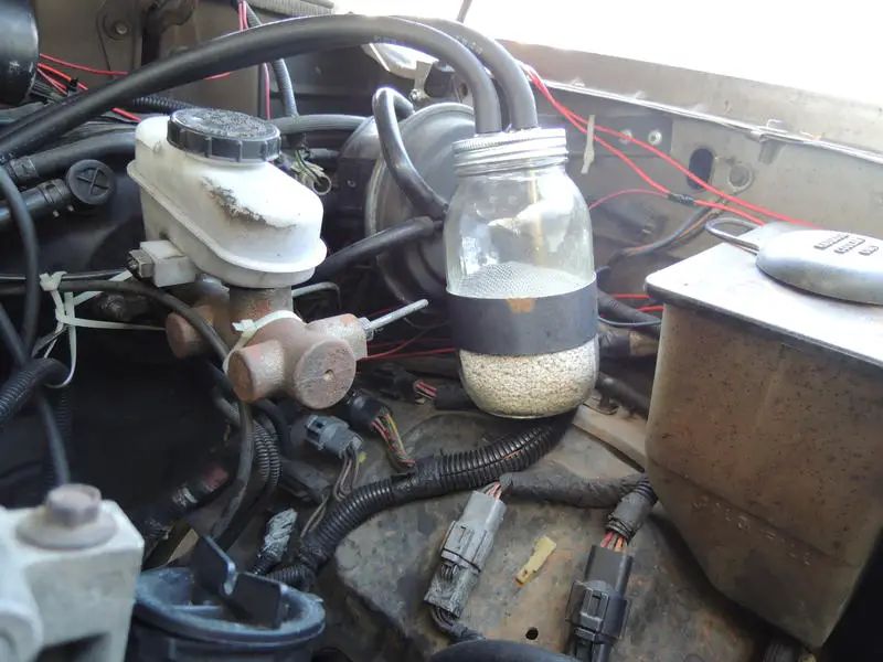

I set one up a catch can on mine when I discovered the new PCV valve I had just replaced was still not keeping the oil from getting sucked into the intake. I made one out of a small mason jar. Basically a jar with inlet tube that went down in and the outlet had a shorter tube nearer the top. But after a while I realized the suction was still so strong it literally pulled the oil up around the inlet tube onto the underside of the lid and in to the outlet tube. So I had use a taller jar extended the inlet tube longer and added oil absorbent media in the jar to soak up the oil so it would not be pulled out the outlet.

About mine? its working out great.
Very innovated. Thank you for sharing the photo's. Let me know how well it works for you.
