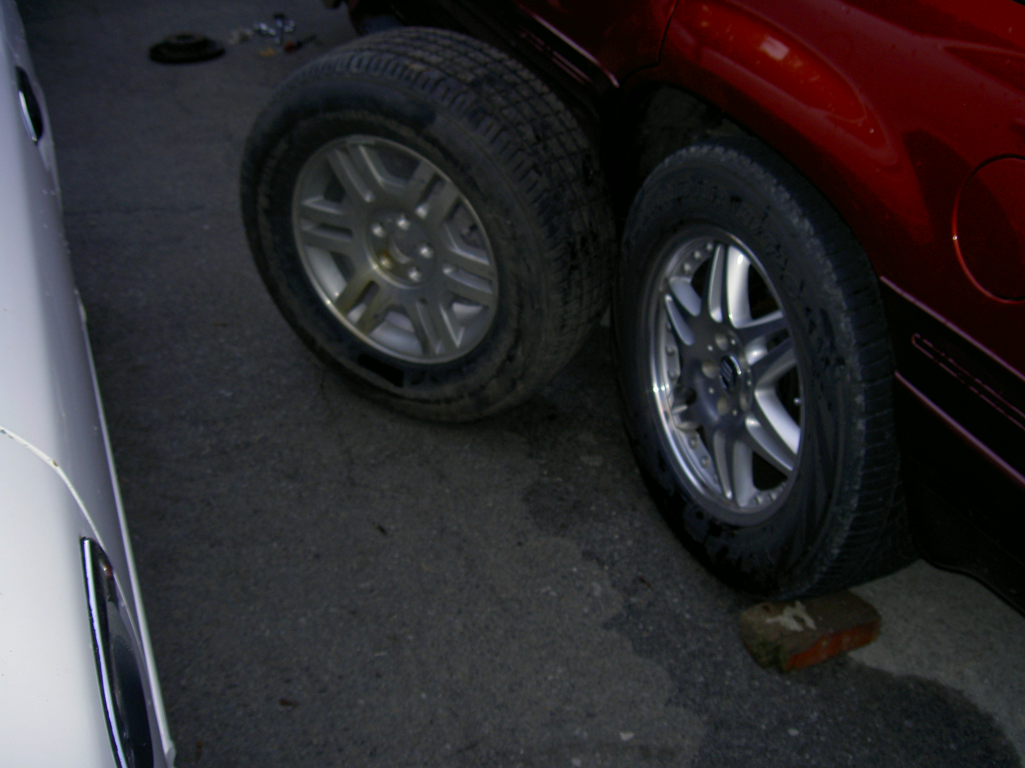

The offset is the biggest issue. That 32mm difference is over an inch that the 3rd gen wheels will fit inboard compared to the older wheels.
I have a spare under my truck that I've never used, but it is a 3rd gen wheel that I chose because it looks a lot like my aftermarket 18's. I tried it on the truck when I got the 275/60/17 tire on it, and it could be used temporarily. But I wouldn't drive it much, it was super close on the front BJ, and that might have been with my 1/4" spacers also. That was 2006, and now it's a spare part to get rid of.

I have swapped my wheels and both look great. I used the 2" wheel spacers on the ST with 17" 3rd gen wheels and 265/70-17 all terrains. I have had lots of compliments and few people offering $ wanting to buy my truck.
