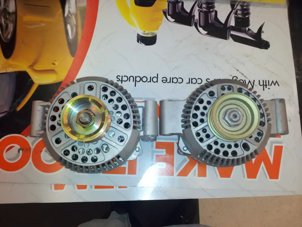

The alt you can get outa the junk yard or buy new.its from a 97+ and is 130 amps
130 on the left
Pulley 1.8 but search sure you can find cheaper and a new belt would be needed also

So here is the thing, I have a "high output" alternator from mr.alternator. When I picked it up from them they said it was rated at 200amps. Now I also have a 4g power wire for this alternator. I could swear that is the very same alternator in my truck.

O one more thing.my alt guy said you can't get the guts in side the old case (4 holes) to make over 130-150.you have to use the newer larger 130 case (2 holes) and even at that he said he could fit the guts to make over 250 reliably and efficient. He makes them at around 220 amp (seen with my own eyes)I had a DB electric one that was 220 I thought and paid for.it blew up and took it to him to rebuild and it was in the small case.he point it out right away and after he opened it up it was just a stock 90 alt!!:(
So if you don't have the larger 130 case then you know your not really putting out over 150 MAX.you can tell them easily apart by the holes in the front of the case;)
