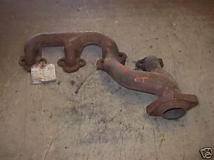

Since no Explorer Sport came stock with a V8 engine they are uncommon. Since no Explorer came stock with a V8 and a stick transmission they are uncommon. Most Sport V8 conversions retain the 4R70W transmission. Since the PCM is required to shift the 4R70W the fuel injection is normally retained. Therefore, there are only a few street Sports with V8 and stick and I'm not aware of any street Sports that are not fuel injected. Most people want the performance and fuel economy that comes with fuel injection. Many people have to worry about meeting emission requirements.
You're probably aware that the stock V8 exhaust manifold is an unusual and rather low performance design. The left one is shown in the photo below.

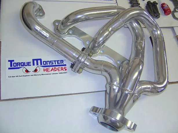

I believe that Torque Monster is the only manufacturer of bolt-on headers for the Explorer 5.0L. The left one is shown in the photo below. TM headers are expensive and also rather unusual but members that have them say the performance improvement makes them worth the money.
