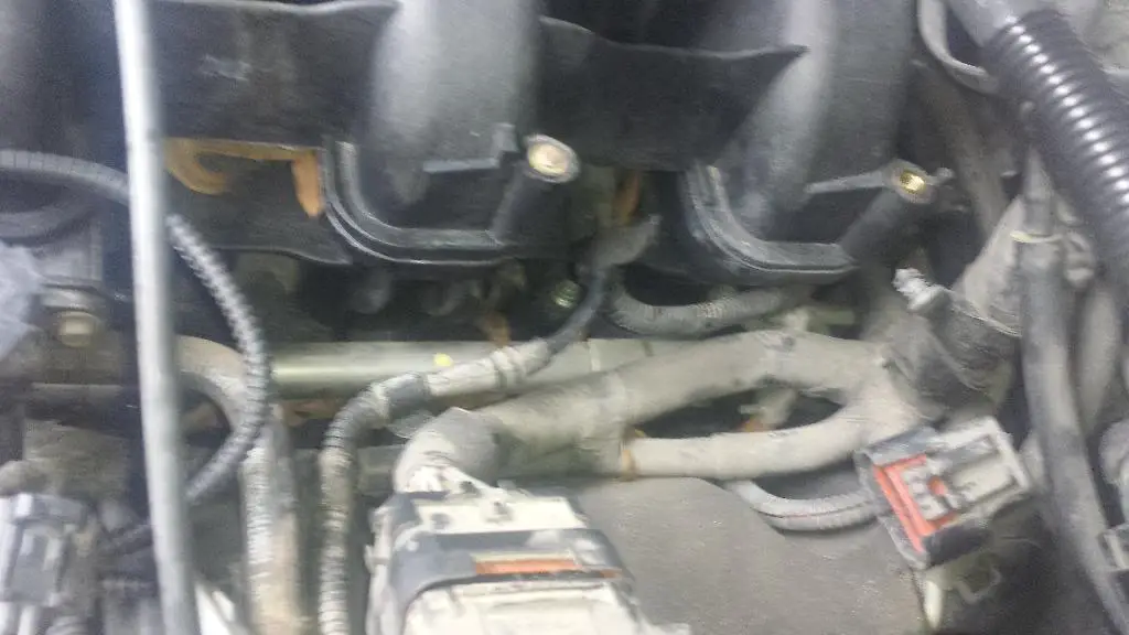

I am in the middle of replacing my valve cover gasket and I am suppose to disconect the electrical connection at the fuel injectors but am having a hard time figuring out how to get them off. Do I have to remove the fuel rail to get acess to the connectuons? The wires and the fuel rail are just blocking the clips I guess.
I just did the same repair. I could not find a clip holding them in so finally just used some very long needle nose pliers to grab the front and back of the cone ecotour and gave it a yank. Seems the right approach. It worked on the other side as we'll. be careful not to grab the wires or pinch too hard.

Alright I am going to try and use some needle nose pliers and see if that works, thanks
Still cannot get the clips off so I skipped the step and was going to disconect a few things to help me get to the clips but I cannot get my fuel line disconnected just like I could not get the fuel line at my filter off. I am using the plastic tool and having no luck any one have a tip?
i wonder if a special tool is really required and i just got lucky. I have no idea what a "cone ecotour" is. I think i meant something "connector". i used very large needle nose, probably 10 or 12 inches. i suspect any other pliers that will let you get a grip will work. Just have to be careful not to break the plastic.

theres is a special tool for the fuel line on the driver side toward the front what i did was if you follow down there is a brace holding the fuel line in unbolt it from the block and pull the valve cover around it.. it will give you enough slack
