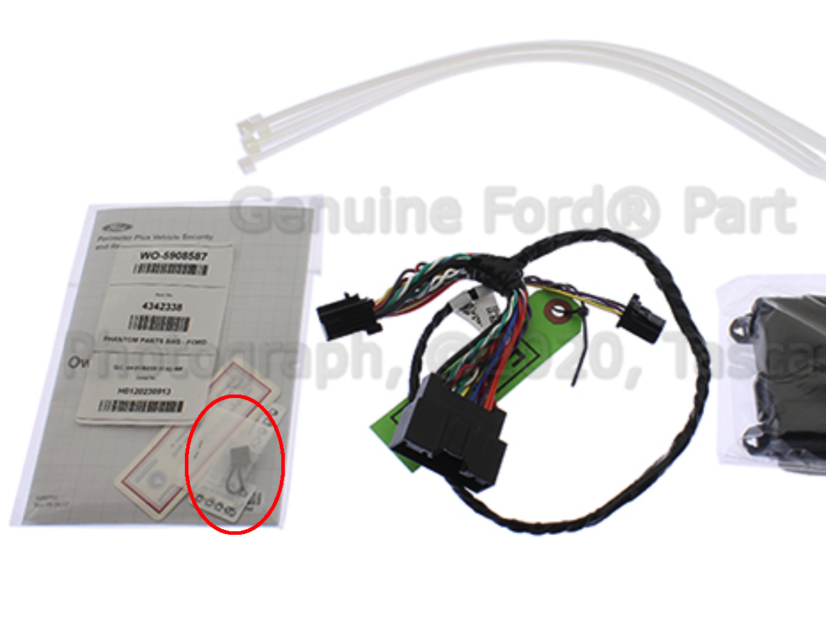

Well in my testing of things. I have lost the jumper for the VSS box. If anyone has a spare or has the part number for the jumper, please let me know!
The plug if plugged in, disabled the "extra security features". if you unplug it will supposedly enable all the extra shocks and sensors to trigger the alarm.
Our explorer is still setting off alarms randomly....I want to try the plug again now that the VSS box is zip tied secured, after that I may try to warranty the part
anyone have that jumper they could take a picture of? I'll make one but need to see the size/type/config

found the jumper. But still having the random car alarm go off once it is plugged in. Has anyone added vss? the forscan options via the f150 seem like there may be something that needs to be done
