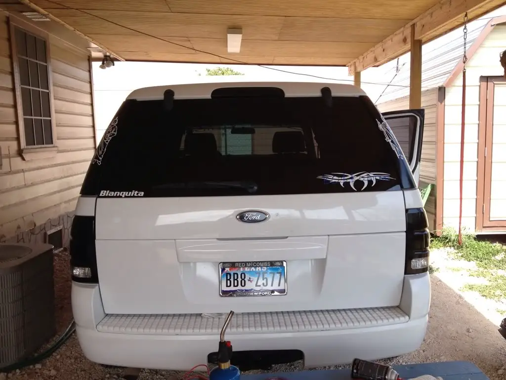

Just clean down your tail lights with rubbing alcohol and dry it off then sand them down with high grid sand paper just to ruff it up a little bit then mark off your reverse light with some masking take and hold the can about 6 in off and make a couple runs over it and let it dry then use a little clear coat and itll look great, thats what i did and you cant see any red on mine

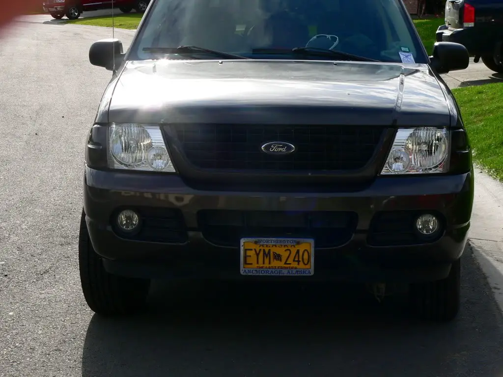

USAF_Firefighter
- July 4, 2010
- 19
- Elmendorf AFB, Anchorage AK
- 05 XLT
tails...
turns..
both..
turns..
both..
