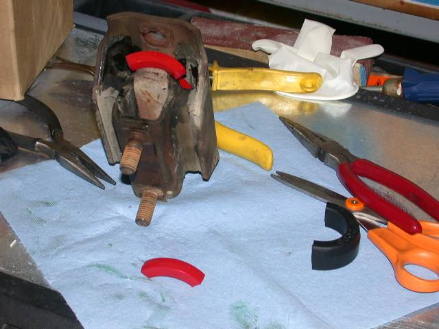

My latest, successful attempt
After replacing many things, including wheels that had curb rash, I decided to try replacing the tranny mount.
$42 from Ford, BUT I did a little modification before I installed it.
I had some parts left over from a poly bushing kit, so in an attempt to make the mount firmer, I shoved a couple of pieces of bushing in the mount. I also took the dampener off the transfer case. Now the vibration is barely noticable and almost acceptable.
You might want to try this next before you spend a lot of money on things like;
Poly bushings all around
New rear wheel bearings
New front wheel bearings
New Brake drums
New rotors
New rims to replace the ones with curb rash
New steering linkage (everything!)
New tires
Several alignments
Let's see, what else did I replace?
I haven't replaced;
Ball joints
Motor mounts
U joints

The most improvement has been with the tranny mount. The Poly pieces have a dampening affect (Poly has been used in several mountain bicycle fork components for their dampening qualities. The Poly is injected with nitrogen bubbles of various sizes to provide different spring rates).
I did the tire rotation thing, I even bought 2 new rims ($186ea) thinking the curb rash they had was somehow a cause,,,,, no on both.
The tranny mount is easy to do, I recommend you put it near the top of your list of things to try!
