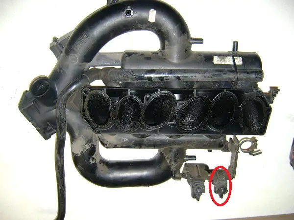

The first photo in post #3 shows the vacuum assembly. The large tube connects to the source of vacuum. The vacuum motor should be connected to the VIS vacuum solenoid which is shown in the lower left corner of the 2nd photo in post #2. Follow the other hose in the pair connected to the VIS vacuum solenoid.

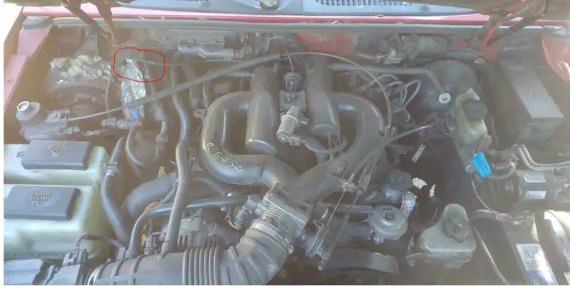

I am sorry for being so dense, but I just don't get what you are trying to tell me. The broken hose is currently connected to the Variable intake Solenoid shown below.
I need to figure out where the other end connects. I have looked and just can't find it.
