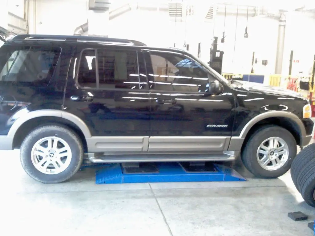

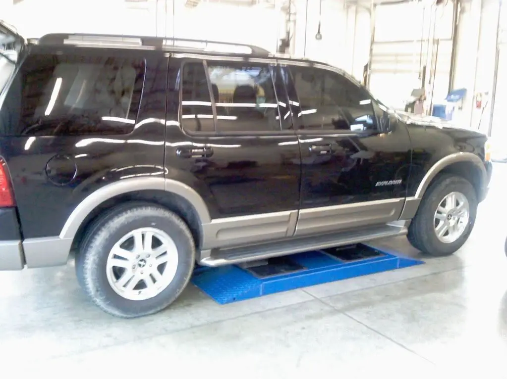

Do you have any photos with those wheels on your Ex.?
Well, I thought I did. I will keep looking, but haven't been able to track them down yet.
I know this is an old thread, and probably dead, but I found the pics!
Wow those look really good. Hows the ride with them on? Any issues with the backspacing?
Ride was smoother than stock, with the big wide tires and all. They were close to the usual contact points (control arms, inner fenders) but not too close. They are a 17x8 wheel with +45 offset, so they are pretty close to stock size and offset. Maybe tucked under the fenders a tad more than stock. I actually have them back now, and am thinking about using them with some 245/70/17 highway tread tires for road trips and stuff. The 20's with 275/55/20 tires are killing my fuel mileage! lol
