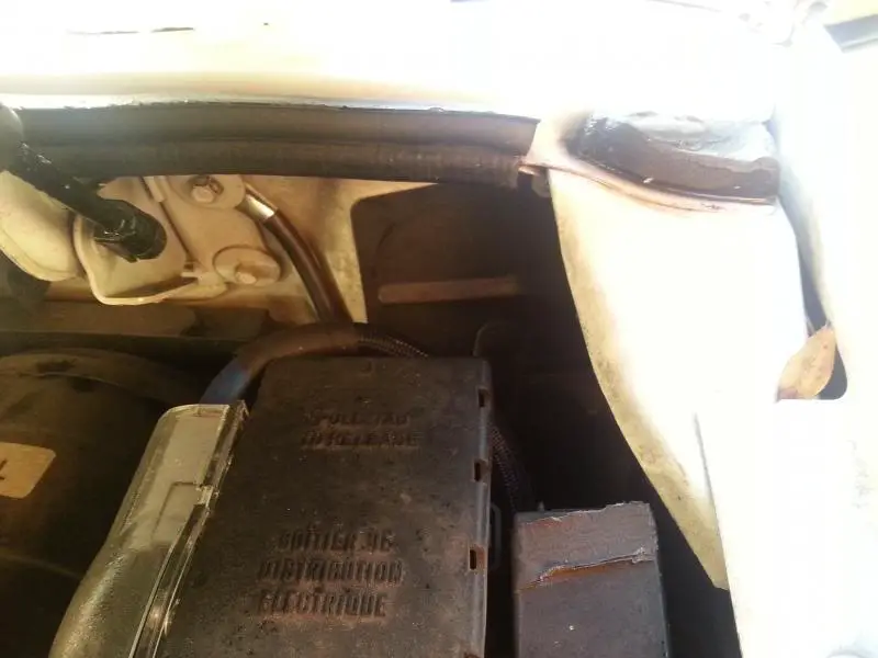

I know this is an older thread, but I experienced the same water leak this week. Bad rains and my floor is soaked. After an hour of water leak testing starting from the bottom outside door jam and working up, I found it.
With the hood up, facing the firewall, look to the right corner. There is a metal plate with four bolts. Below that you see the body seam with the factory seam sealer. That seam sealer is the leak. I'm putting silicone all over it and the body. First, I sprayed it with bleach water to kill mold and mildew. So it has a clean surface.
And if you are wondering how its getting there, with the hood up look where the rear edge sits. The water funnels from the fender, hood and metal cowl down in that area. Isolating the water only in that area resulted in water inside. With you head in the driver pedal area, look to the corner and pull back the rubber insulator. You will see a body seam there. You might even have a moldy spot or rusty looking. That's the other side of the seam sealer. This is from my phone.
To add to this. I bought "Permatex Flowable Silicone Windshield and Glass Sealer". Small size tube. This is much easier to work with, considering the lack of space. Plus you can start at the top of the OEM sealant and squeeze, it will follow the path with no need to smear it along the joint. So it will also fill the cracks/voids.
It appeared to be coming from behind the E brake pedal assembly. But that was from the rubber insolated catching the water and flowing down dripping right at the cable grommet.
JChrisMarion, I'm still living with the leak so thanks for dredging this back up! With this pic, can you guide me a little closer? Looks like I may have to remove the brake booster, wiring harness, fuse box or something because I'm not seeing an area that catches water. Many thanks!!
Thanks for the picture, leoJr. This is just what my 99 XLT 4.0 looks like, also. So I am puzzled too. Does he maybe mean that little bit of foam at the bottom of the 4 bolt hood hinge support? Doesn't look like a body seam to me, either.
Was on vacation. Using your picture, look at the black metal plate bolted to the firewall behind the relay panel/fuse box. Below that plate you will see the seam of the body and firewall joined with factory seam sealer. Start at the corner and squueze the tube. If you buy what I posted, you need not remove anything. Wait one hour to dry and apply again. On top and bottom of the seam sealer. It flows out real good and will follow the seam with gravity. Sealing up any cracks and voids. My second coat I applied extra. You can also apply it watch it flowing along and then hit with a hair dryer or heat gun to get the bond started. Wait and reapply.
