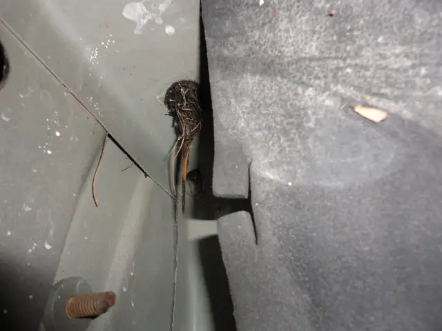

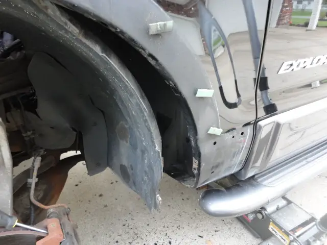

Update: I found a hidden, plugged up solid, windshield cowl/fender drain hole today. I decided to follow "Ted22"s" info on opening up the driver side inner, fender well weather shield and separate it from the fender. To do this, I had to remove the wheel first, then the fender flare along with the plastic push pegs that hold it in place to the fender. Then I had to pry the inner weather shield out from behind the fender edge and only removed half of it from the fender to give me enough of a access space to search for the drain hole up inside the fender area.
I then took a flashlight and laid on the ground looking up (very top) into the space behind the fender and this is what I saw at the top of the picture shown:

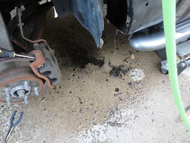

I started pulling out this rats nest of old tree twigs, leaves and dirt with a curved windshield gasket tool I have that helped me reach inside this drain hole and start pulling out the debris. This is the driver side cowl drain hole. The next pic shows a pile of the debris laying on the ground after I pulled it out of the hole.

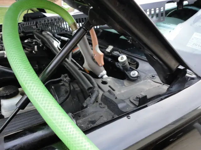

After removing as much debris as I could, I then went and removed the windshield wiper arms and cowl. The wiper arms just pop off after you rotate the small slide tab near the base of the arm, installation is reverse of removal. The cowl itself just pops off, and has tabs that seat into holes under the windshield cowl. I then took a garden hose and placed the spray nozzle of the hose in behind the fender from inside the cowl area, as deep as I could get in there going back towards the inner fender and started spraying water. The water began gushing out of the fender hole that I showed plugged up earlier. I shot water thru there till I was satisfied that water or rain water could drain properly now. I assume there is a fender/cowl drain hole on the passenger side of the vehicle as well, but I have no water under the carpet over there so I didn't go looking for one at this time.
Hopefully, this will stop the rain water from leaking into my driver side foot well and the pics help others with this problem know where to look and what to look for.
