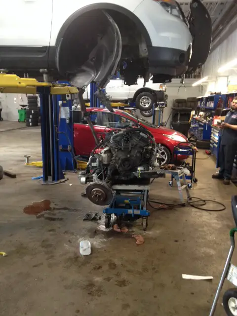

Well, my Explorer PI needs a new water pump, which is why I found this thread!
I noticed coolant, just a bit at first, just below the AC unit. Wiped it off, no big deal. Didn't leak again for about a month, and this time it was a large leak after a short drive. Found this thread, and was like "Uh oh!". Lucky for me it leaked outward, I guess.
Took it to Ford today, and yep, water pump. $110 part, $2,200 total. The girl told me that the engine has to come out to replace it. Nice engineering, fellas!

Ya, I talked to the shop foreman, and he said its up to the tech, but he says its easier to drop the motor and do it that way, and quicker he claims. I saw those vids on YT.
FYI, the water pump is on national back order, and they don't have any idea of when they can get one. Its on emergency order for mine...

My Explorer is a 2013 Interceptor Utility model, retired DRPS here in Canada. Despite the mileage, it drives excellent and idles so smooth, you have to check its running. It really is in great condition. They took great care of this one.
Having said that, it has 229,000 kms / 142,000 miles and 5500 idle hours, so its been used for sure, so I'm not surprised it failed. What I am surprised at is where the pump is, and the cost to replace a $100 part.
I'm going to confirm with Ford tomorrow that they are looking for the correct part number, as the one they gave me doesn't match what I see on fordparts.

Yep, its done. They replaced the timing chains, crank seal, and spark plugs while they had it out, in addition to my failed water pump.
There is a special place in hell for whoever designed this engine...
Here it is!
