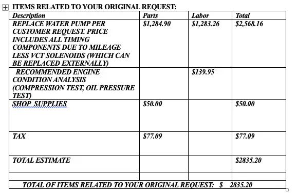

My dealer quoted me $ 2,835 ($1284 in parts, $1283 in labor, plus misc) to replace the water pump and all other internal timing components in my 2011 Explorer Limited with 178,000 miles on it. He said they might not need to replace everything on the quote but since visual inspection isn't aIways telling and given the mileage I should expect this amount. I am now trying to decide if I want to do this "preventative" repair or not...

That's going to be a difficult decision. I believe most failures have occurred before members reached that mileage so you may be fortunate and not have a failure. Hard to say. There are others with high mileage Explorers that have not had the issue as well. Another thing to take into consideration is what sort of shape the vehicle is in regarding suspension parts, powertrain and body. Have you had or do you have the hood paint bubbling issue on the front edge?
The vehicle is in really good shape otherwise, we have maintained it well over the years. I don't have the hood paint issue (but will verify that tonight), I do have a small issue with rust from inside the tailgate on the lower right edge near the drain hole. This has been an issue from within the first year of ownership. I just need to open the plug and spray some Fluid Film (or other rust preventative) in there and clean up the rust on the paint (again - been doing this every couple years). I am noticing small signs of rust down low on the inside of the doors, just early indications, but also something that will progress. There will be some needed suspension work coming up (6-12 months I suspect) as I am noticing roughness and hearing sounds that usually indicate that.
It is a crap shoot on a vehicle with this mileage though, I could spend the money and realize a month or year later that it needs another $3000 for something else. Damned if you do damned if you don't...sigh
Or I can just hope it lasts another year until I can buy that Bronco I want :)
With 178K I would comfortably say you got your money's worth. At this point, imo, it's likely not worth investing that much in maintenance. I would drive that vehicle as long as I could get away with repairs/maintenance that are less then around $500. Tires maybe being the exception. Otherwise, I see that money being better spent on a down payment towards a newer/ lower mileage vehicle. Who knows, you might just be the guy that got a water pump that will last for 250K!! Enjoy the ride!
I agree. Don't spend 2k to 3k on something that may not happen. I just dumped the last 1k into my 2011. No more big bucks for my car. Mine is rusty in those places but did use wire wheel and POR 15 to clean it up. I guarantee your hood has corrosion but that can be masked by a 60 dollar bug guard.
I would only replace the timing chain guides. This is what typically goes bad. The chains and sprockets in these engines are fairly robust. The guides shouldn't be all that costly.
If he does that, he may as well replace the water pump since it is internal to the engine.
Agreed, once they've done all the work to open it up why not replace all wear items in there.
PS: I am kind of leaning towards rolling the dice and waiting to see what happens as some have advised. I am not opposed to making it habit to inspect the dip stick...
I am referring to the timing components only. I thought the pump being swap was not in question.
