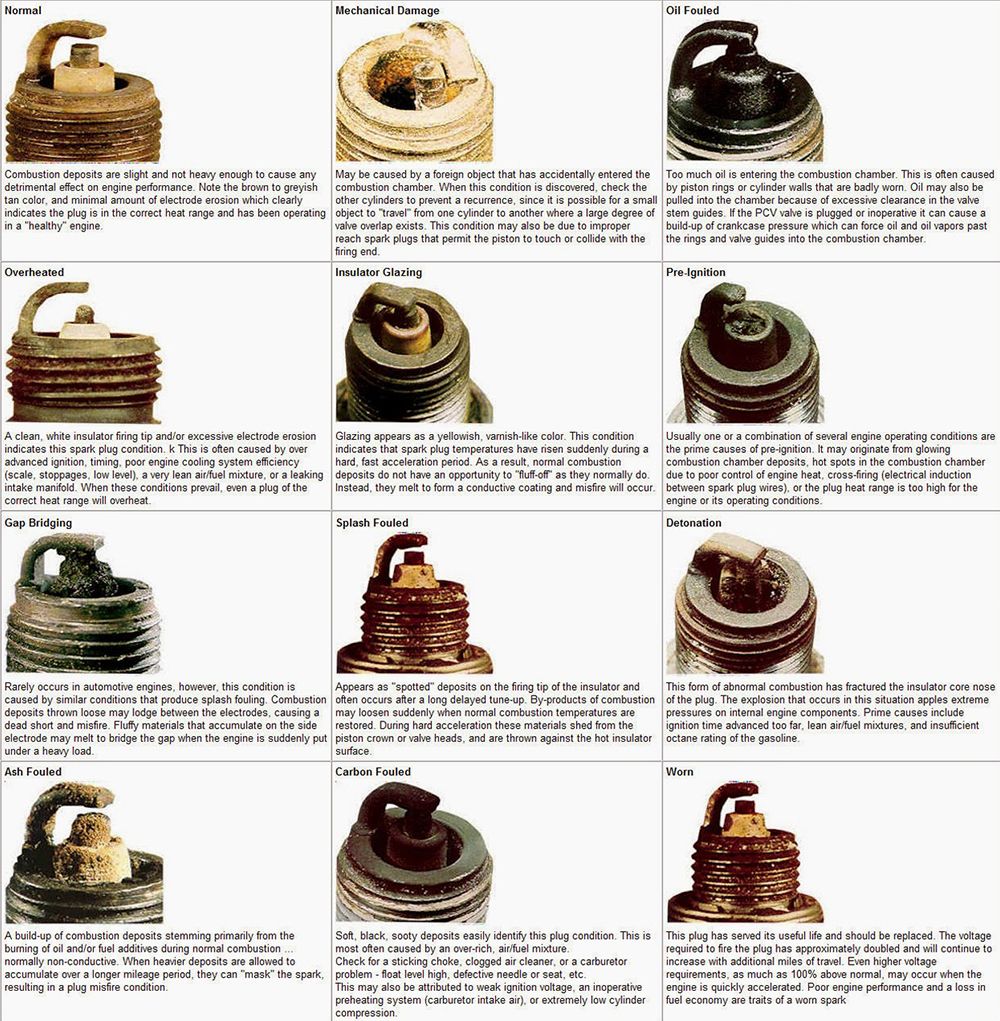

The only one that looks concerning is number six. Would suggest burning of oil fuel, additives, or poor fuel.

Looks like theres deposits. I agree with NumberFour burning a little oil
It can be part of the cause. But that suggests theres an underlying problem changing plugs might mask but wont cure the root cause.
