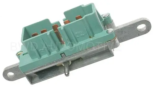

Sounds like when you turn the key off it is not actually OFF.
Ignition switch is likely the bad guy.
The dash lights go out though, would this still be my culprit?
