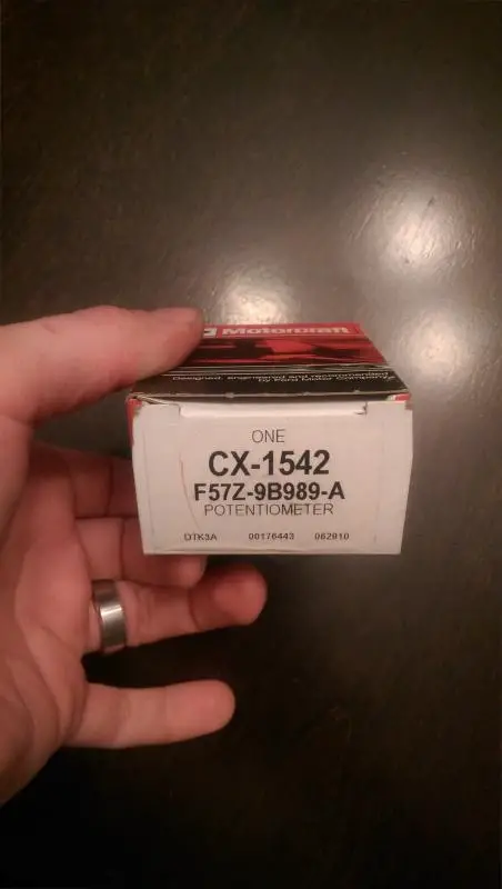

So I received my new tps directly from AutoNation Ford ( formally Tousley) based off my Vin number. Opened the box and to by complete dismay... It's the wrong one again. This is partly my fault as I initially ordered the correct sensor and a rep called me back and talked me into a different sensor. I figured he would know better than me... Honest mistake as it seems even Ford's catalog is a bit confusing here.
I call Tousley up and talk with a rep. He says based off my vin (x vin btw) that should have been the correct one but obviously wasn't. He did some more cross referencing and came up with CX-1542 or F57Z-9B989-A
Luckily they are local to me so I drove over there after work and swapped them out. While still standing at the counter, I checked the rotation direction and it was correct.
Got it on the truck and pulled out the multimeter... And I have variable voltage finally!
