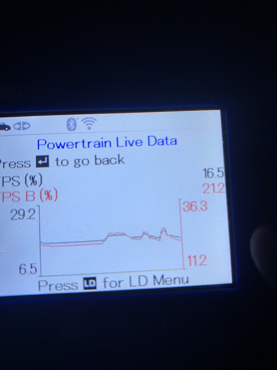

So I did all the tests and this is where I need help. At idle tps 1 is at 16% tps 2 is 22%. They adjust simultaneously but with a wider range the further the pedal is depressed. Neither are erratic on the live data feed. I back probed the tps sensor and read normal according to everything I’ve read. 5.02-5.06v. With a 3.5v ground.
so…am I looking at just replacing the tps sensor? I’m already planning to get a junkyard sensor for it to just throw on if that’s the case. My concern is, what is the possibility of that trans fluid leak causing unknown damage to wiring or what else do I need to be looking at? What other testing do I need to do? Are the readings normal at idle? I’m running to the junkyard tomorrow to grab a sensor anyway, which will really just tell me but I’m more concerned about the trans fluid that got all over.

I don't see where the original post says anything about a tpms sensor. I do see where he is talking about a tp sensor and that is a throttle position sensor.
I believe the p2145 is the same code i had on lincoln navigator and replacing the tps fixed the problem. Fordtechmakuloko on youtube did this video
This is what i used to diag the problem on the lincoln. He also has a video on how to replace it without breaking it.
