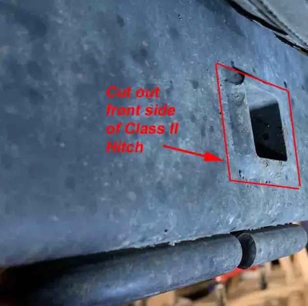

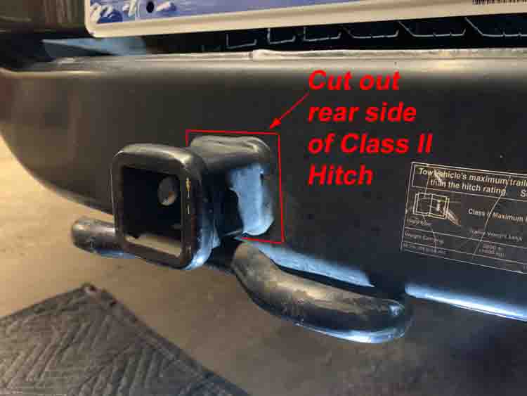

I am facing this issue now, plan to have a welder flame cut out the 1 1/4" receiver and weld in a Curt 49060 6" long Class III weld on 2" receiver.
