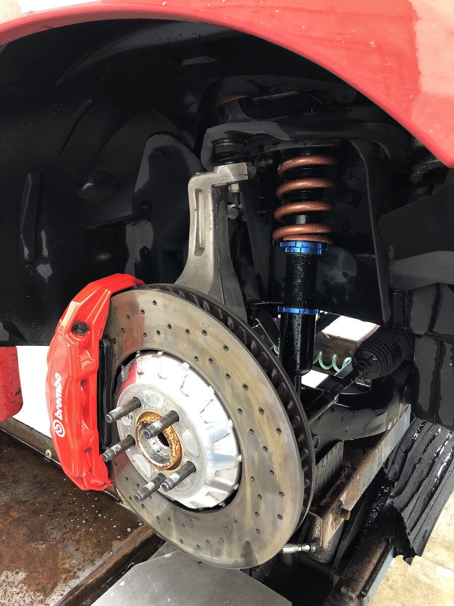

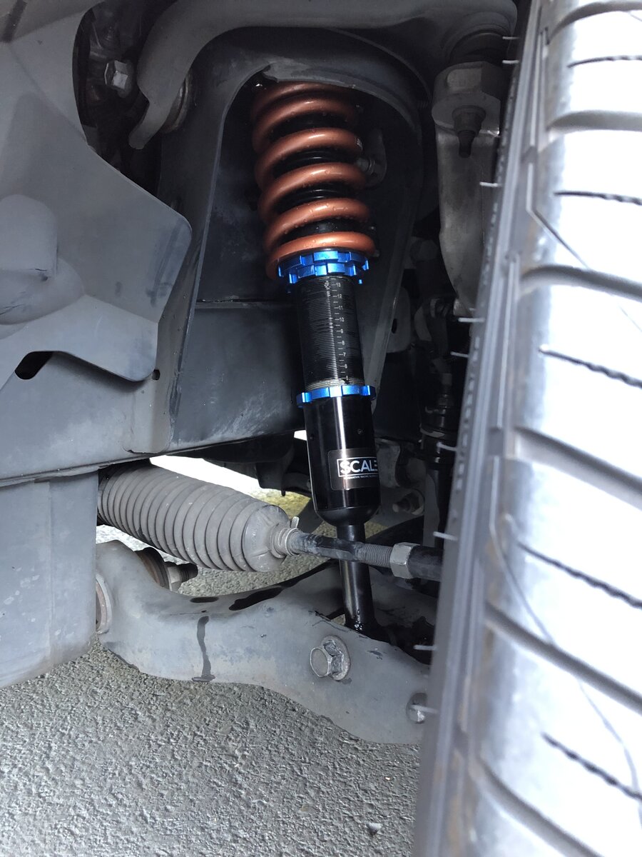

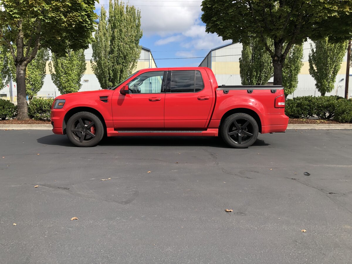

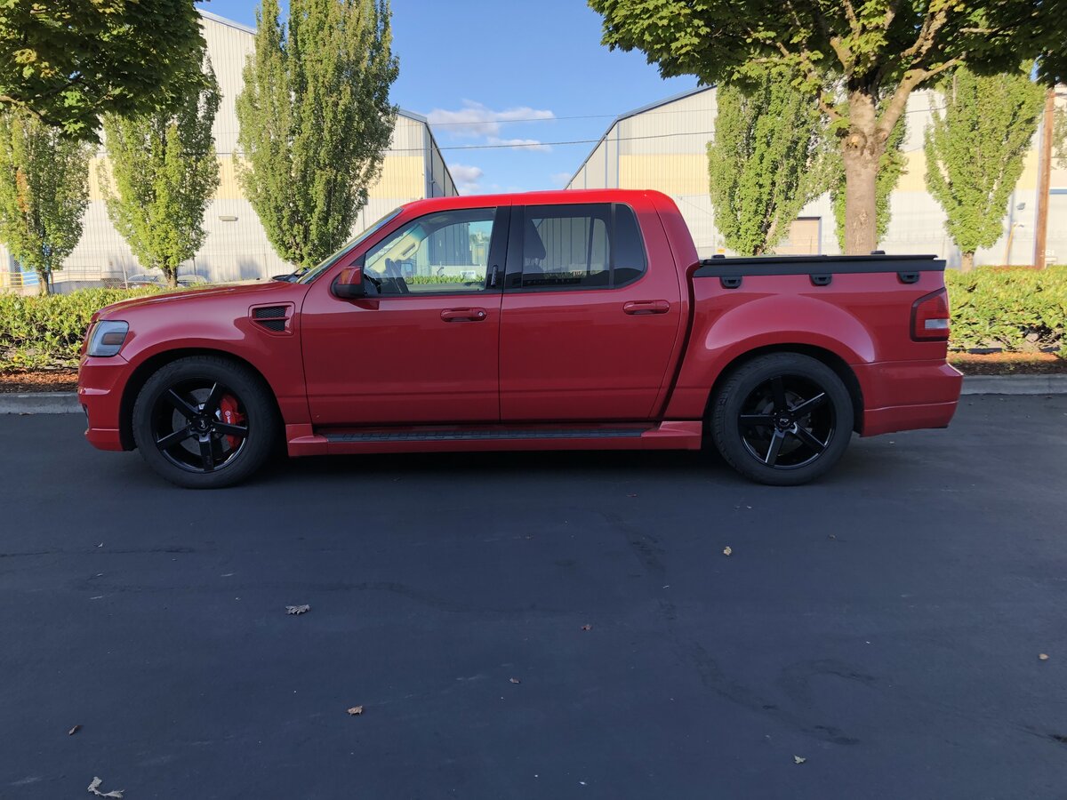

awesome thanks for sharing those pics! only reason i am hesitant on the scale setup is i'm not sure of the impact to towing capacity. any thoughts there? do you think the rear spring rate is high enough to still be able to tow a little bit, maybe a pwc or small trailer?

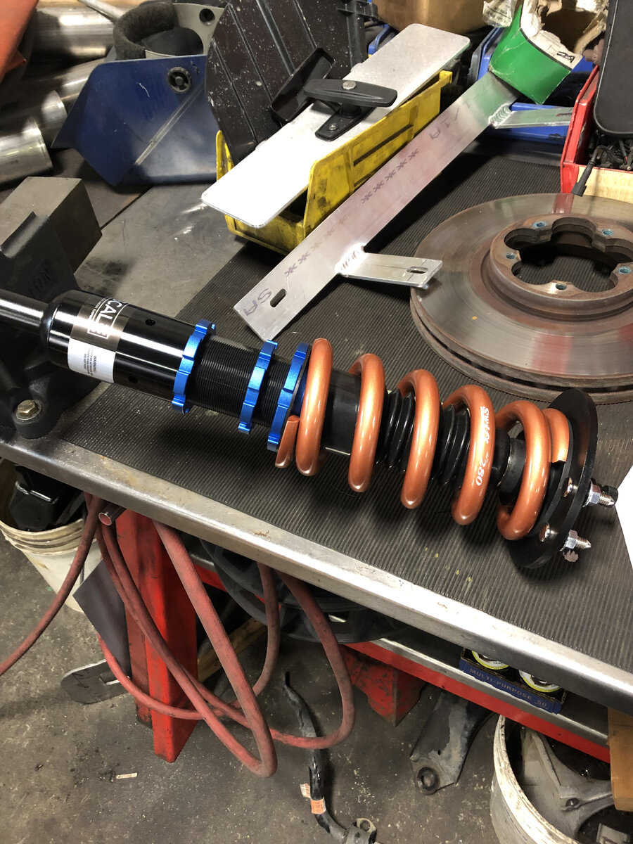

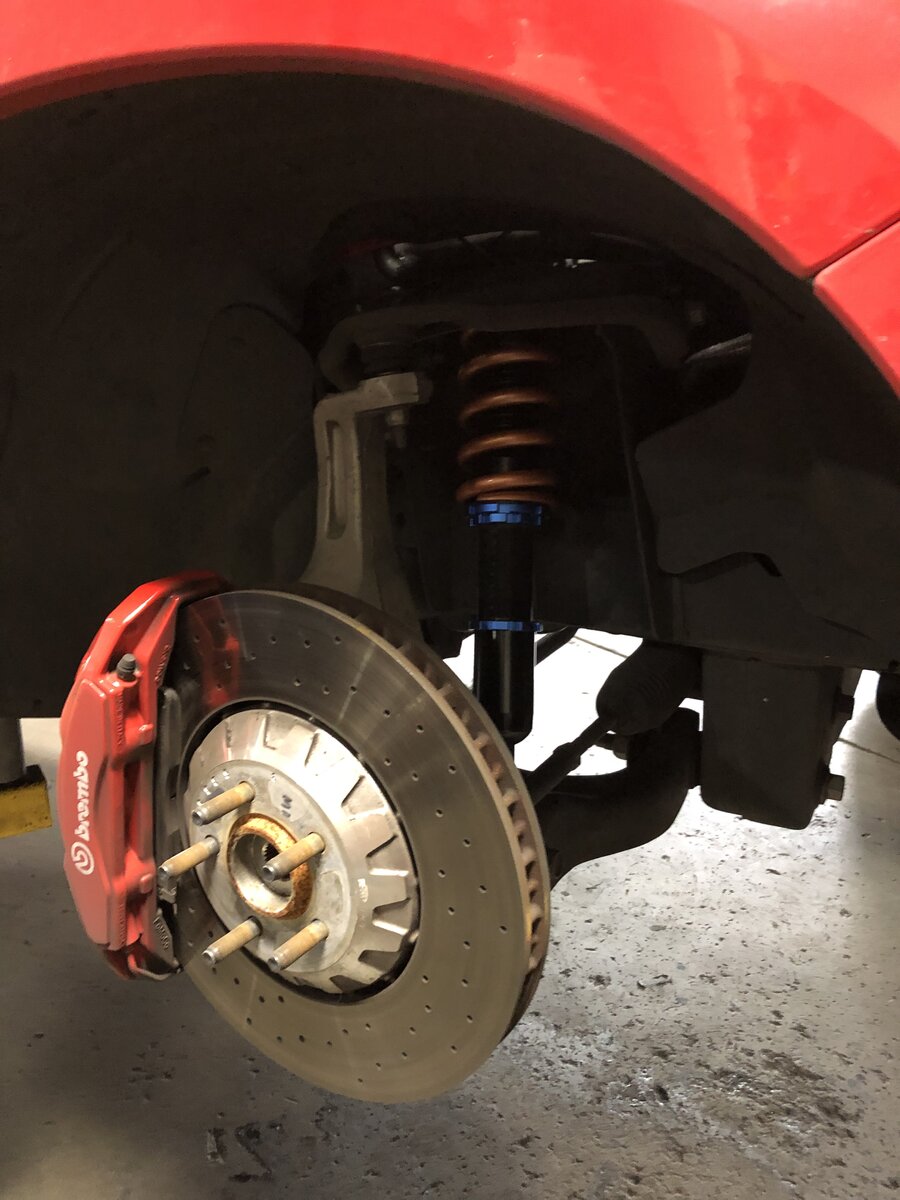

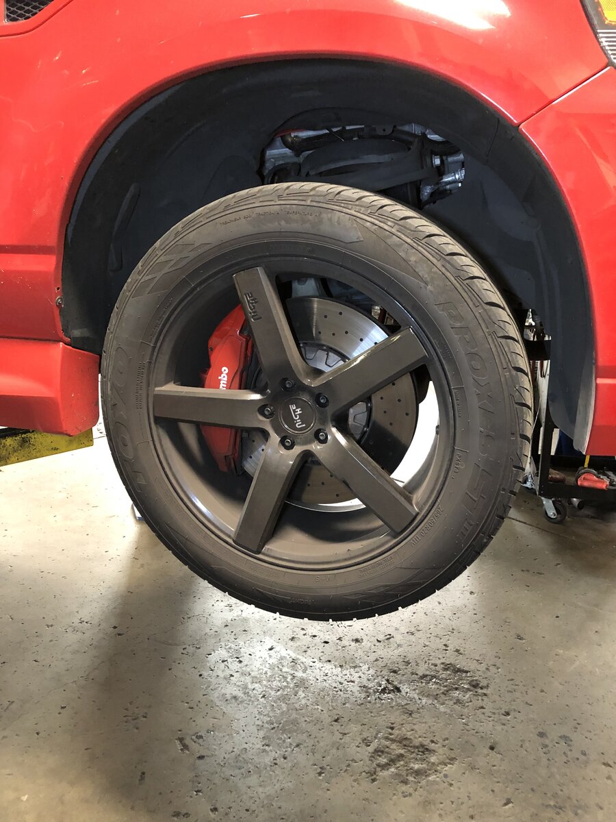

What size wheel/tire combo is that? Also, did you lose or gain sidewall clearance with the Scale setup?Scale is a good company to deal with, each customer is a custom build, they will ask you what your going to expect from shock, In my case the truck is going to be drag/street with a 5.8 gt500 engine North of 800 hp. Very nice choice like we have any.
Did you install the Scale coilovers yourself or have it done in a shop? If shop, what was the approximate cost? Did they have to do a realignment? Thanks.What size wheel/tire combo is that? Also, did you lose or gain sidewall clearance with the Scale setup?
NetDid you install the Scale coilovers yourself or have it done in a shop? If shop, what was the approximate cost? Did they have to do a realignment? Thanks.
Did you do the install yourself, or a shop? If a shop, what was the cost and did you have to do an alignment? Thanks.Scale is a good company to deal with, each customer is a custom build, they will ask you what your going to expect from shock, In my case the truck is going to be drag/street with a 5.8 gt500 engine North of 800 hp. Very nice choice like we have any.

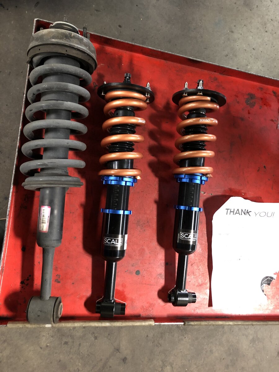

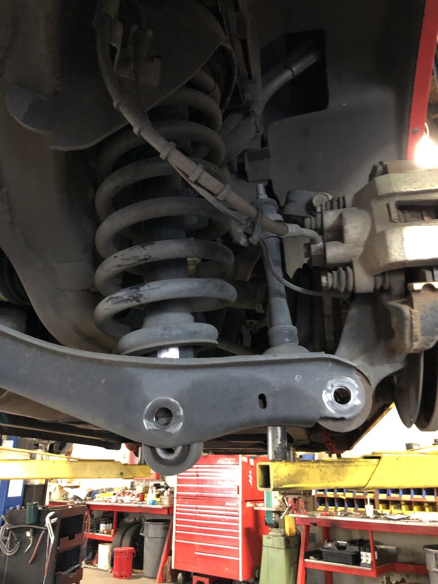

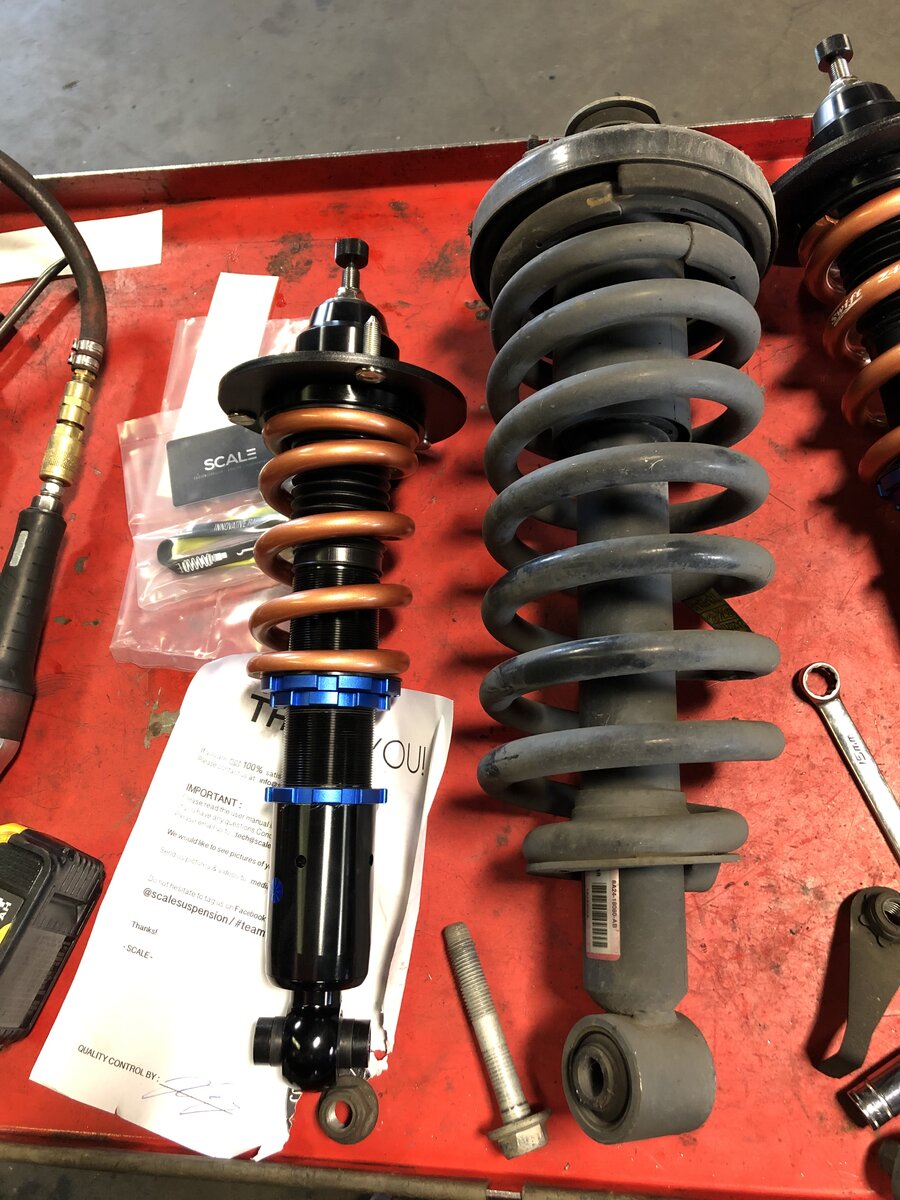

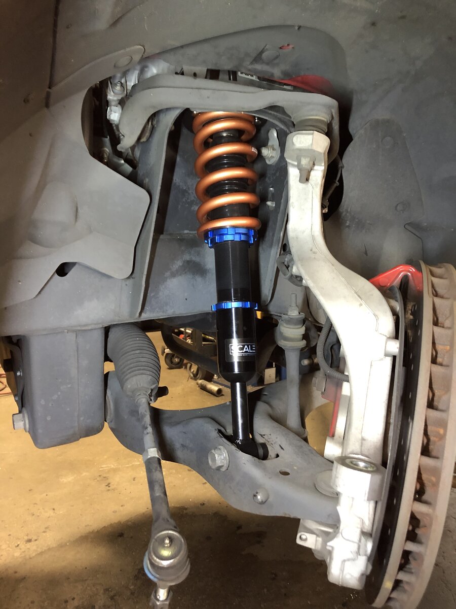

Thanks for the reply. I will give it a go.Yes I installed them, easy. I happen to own a shop with 2 and 4 post racks I like the 4 post with bridge jacks best, don’t even have to take the wheels off.
with a floor jack and the proper tools a bit more work.
