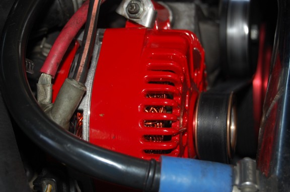

The only negative I have about Mr Alternator is very slow delivery.
i understand you had a backordered alt tho correcT? how long did it take and is that because it was backordered? :-/
They never said anything about backordered.
The delay ( and it was about 2 1/2 weeks ) was most likely due to the red powdercoating.
