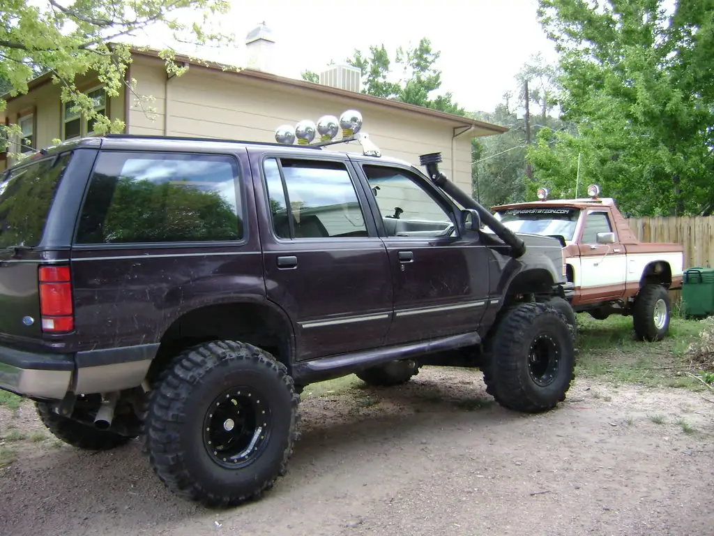

Whatever BL you get, just make sure that it comes with the brackets to lift the bumpers also.
Before brackets...........
After brackets.......
The brackets IMO make or break the BL........(sorry, don't have a straight on rear for the after)................BLOOD:salute:
