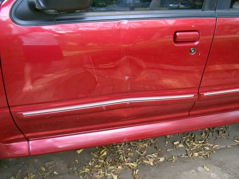

Hey Body work guys, first post here...hoping you could help me out.
About 2 weeks ago, I had to avoid getting hit head on on a 2 lane road , and unfortunately ended up hitting a street sign which dented my door in a few places. It doesnt look too bad to me, but I was wondering if this is something that a Paintless dent repair could fix, or what my other options are. I'd like to keep it as cheap as possible :o Here are some pics.
the paint is actually chipped out so the paintless dent repair wont work on that.. it will need to be repainted..... i say its probably cheaper to find an explroer wrecker, and get a door off one that isnt damaged
yeah you are WAY beyond paintless dent repair.
PDR's do dings and that for the most part is the extent of it.
Your door is caved in and you may have bent the intrusion beam.
I am gonna say a new door is in your future. ( or at least it should be )
Thanks for the help guys, I'll start looking around at some junkyards. What is a fair price for one of these that is in good shape?
