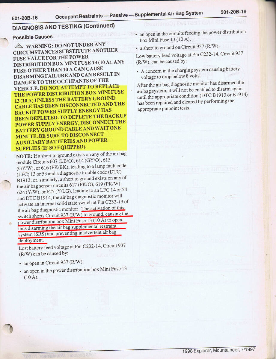

Thanks, after researching the issue I found out that I needed this to clear the code after I fixed it - bought the $20 version on amazon and downloaded the free forescan and now the Air bag light is out and system works.
Posting to close the loop on this, in case anyone stumbles on to this thread in the future.
There is an issue with the ford airbag system that can occur if you run the battery completely dead (as my daughter found out). When the voltage to the air bag system drop to below 8 volts the air bag indicator will flash a 12 code which is what I had. If it goes below 5 bolts it also stores a DTC (trouble code). In my case the voltage got so low that the air bag circuit got confused and thought that there was a short to ground and to prevent the airbag from activation when it shouldn't, it has a circuit that automatically blow one of the two fuses to the air bag system (the 10 amp one).
Now for the 98 specifically - I have the official Ford shop manual and it said that the fuse that it will blow would be mini fuse #13 in the power distribution box, but the 98 does not have a fuse in this position (or at least the 98 xlt SOHC 4WD model doesn't). Luckily I also have the ford official electrical, vacuum and troubleshooting manual and it showed on the electrical schematic that it was actually mini fuse #5 that should be blown and it was.
Once I replaced the fuse, the 12 code changed to a 52 code as the manual said it would once the voltage issue was fixed. Now here is the issue, this code locks in and there are only three ways to get it to clear it, go to a mechanic and pay them to clear it, go through the start up cycle 256 times without a fault (after that it runs out of memory and the code is cleared) or buy the ELM 327 and download Forcan as was recommended to me above. I bought one for $19 on amazon and it worked like a champ.
Now one final caution, you must disconnect the cable from the negative battery terminal before pulling the 10 amp fuse (#13 or #5 depending on your explorer year) or the air bag circuit will blow the fuse for you (I think when you put it back in). That is clearly stated in the shop manual.
Good Luck
PS if anyone disagrees with any of this I can scan in the ford manual pages as proof.
It seems dubious to me that the fuse would intentionally be blown. Yes post the manual pages. it can only be a positive thing. ;) and adds to the knowledge base about this issue.

Dubious or not, here it is in black and white from the ford shop manuals. The first page has the warning to disconnect negative cable before pulling the fuse (you can search and find where people have accidently pulled this fuse by mistake and it has blown -giving them the 1-2 code). The first page also discusses the circuit that will automatically blow the fuse.
The second page may be just valid for the 98 only and shows that the fuse in question is actually the #5 mini fuse not the #13 mini fuse, which is a good thing because there was no fuse in the #13 position on my 98 and I'm the original owner.

Thanks. I meant it seems dubious that they would design it this way but they must have felt this was the lesser of two evils.
