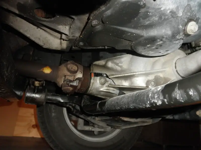

This is on a 2002 4x4 Ford Explorer v6 - Front Axel:
What exactly did I break? Any suggestions for an upgrade of some sort since I have to replace this anyway?
My truck has made a grinding noise when turning pretty much since I bought it (70k miles) so I think this has probably been a long time coming. I'm at 130k miles now.
The 4x4 works probably only 30% of the time when I want it to. Otherwise it won't go into 4x4 or it will say its in 4x4 and nothing will happen. Further, it sometimes locks itself into 4x4 all on its own when its not needed. Do you guys think this is related / going to fix those problems?

Holy crap you broke your axle housing.. Umm Did you hit it on a rock or anything? Time to get yourself another front axle housing and swap it out.
No. I did a doughnut in a grass field. :D Nothing hit it. Didn't seem like I was hardly stressing the car either. Wet grass, smooth surface. Just flipped her around a bit. I'm gonna guess 4x4 popped on quickly and broke it.
Is it just the housing? Whats inside of that thing? Think anything else broke? What causes the grinding when I turn? I figure while its out wouldn't it be best to just fix all my problems.
I'm going to guess its just a differential in there then the axle to the wheels. The differential is probably whats grinding right?
you will probably need a new front differential,

Holy Hell! I would say something has bound up inside your front differential for some reason. This would make a noise when turning, with your front wheels wanting to spin at different speeds but not able to, due to the bound up differential. It was the differential casing that finally gave up in the end.
I believe nothing you have done has caused this to occur. The previous owner would have noticed the noise and sold her off. A "time bomb" so to speak but an easy/cheap enough fix none the less, now you know what is wrong with it.

If it were up to me I would get the whole front diff from left CV joint to right CV joint from a wreckers or ebay perhaps.
Thanks for the pic, I love to see carnage!;)

That explains it ! :p: Your auto 4x4 system most likely kicked in due to the doughnut wheel slippage on wet grass. Explorers aren't the best vehicles for doing doughnuts in. Get your yourself a 1987 or earlier rear wheel drive car and spin yourself dizzy in circles! :confused:

Too bad your Explorer can't speak on that one, but then again, your picture of the broken diff housing speaks a thousand words. :nono:

You got it. That is my guess. The tight turning radius of the doughnut spin probably didn't help matters either.
>>>>>>>>>Is it just the housing? Whats inside of that thing? Think anything else broke? What causes the grinding when I turn? I figure while its out wouldn't it be best to just fix all my problems.>>>>>>>>>>>>>>>>>>>>>
Gears that mesh together, I think a "Yoke" and seals are inside of the diff housing. You probably broke some other things (gear teeth) inside of it and that stress fractured the diff housing is my guess.

Judging by the number of written responses, this breakage is of real serious interest! Not often seen, I think. Anyhow, if one looks at differential housings from DAY ONE up till now, almost nary a one will be found to be made of aluminum.
Wonder why? imp
Edit: IMO, that break likely had to have been caused by jammed ring & pinion gear teeth, probably from one tooth chipped or broken off, lodged very quickly between the next 2 meshing teeth, placed EXTREMELY high loading moment on the pinion gear, which normally tries to "climb" around the ring gear anyhow-- remember the wheel-hop at the dragstrips years ago? Pinion climbed upwards, wound-up leaf springs, traction broke loose, springs unwound as pinion (and housing) un-wound, then the cyle repeated itself. Just a thought, as to the cause, which is now a moot point.
Strictly conjecture.
