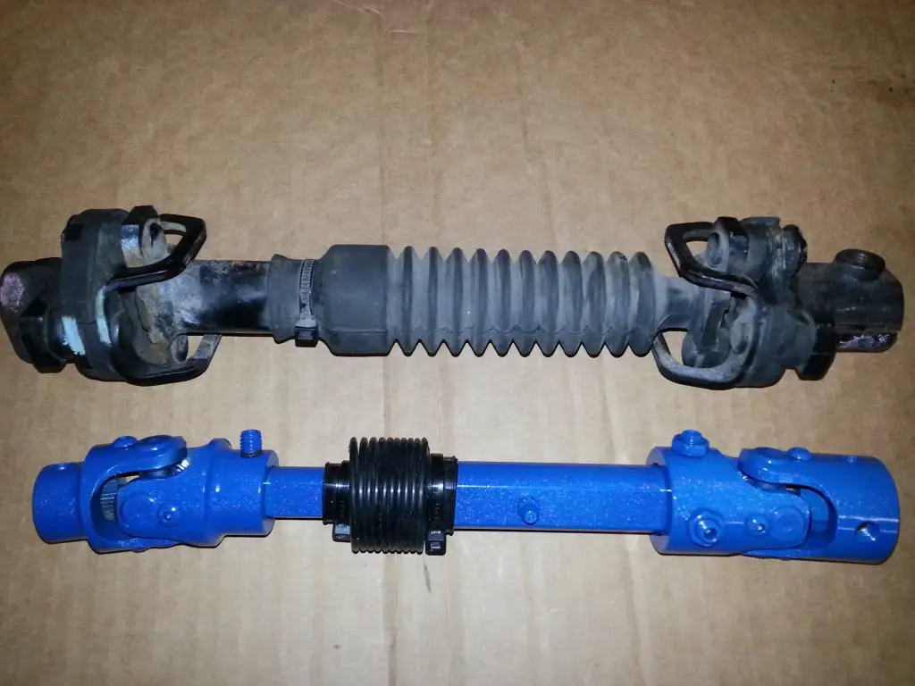

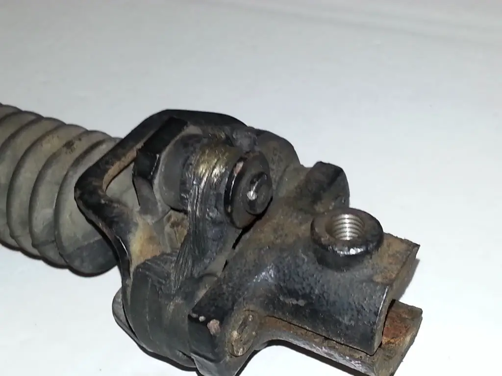

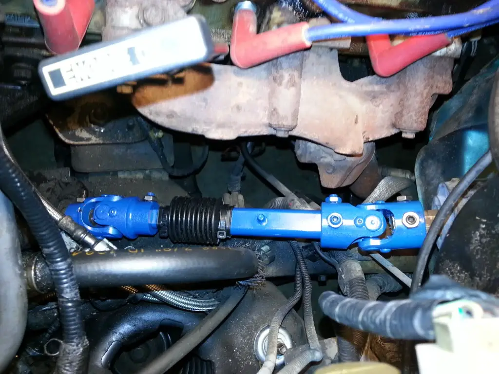

Ill add my $.02 like its been said find out where the slop is.if you adjust your gear box do it in VERY small amounts.test drive every 1/8 ish of adjustment. The steering wheel needs to be able to reset to center if you turn it a lot and let off off it (try at slow empty roads) if you adjust it to far the wheel will stay in a turned position and not spin and recenter.next if you have the rubber rag joints get rid of them.some first gen came with ujoints.if not you can make your own shaft, also a good idea if your lifted or have a BL.
Here are some pics of how bad the joint can get and my new shaft.
