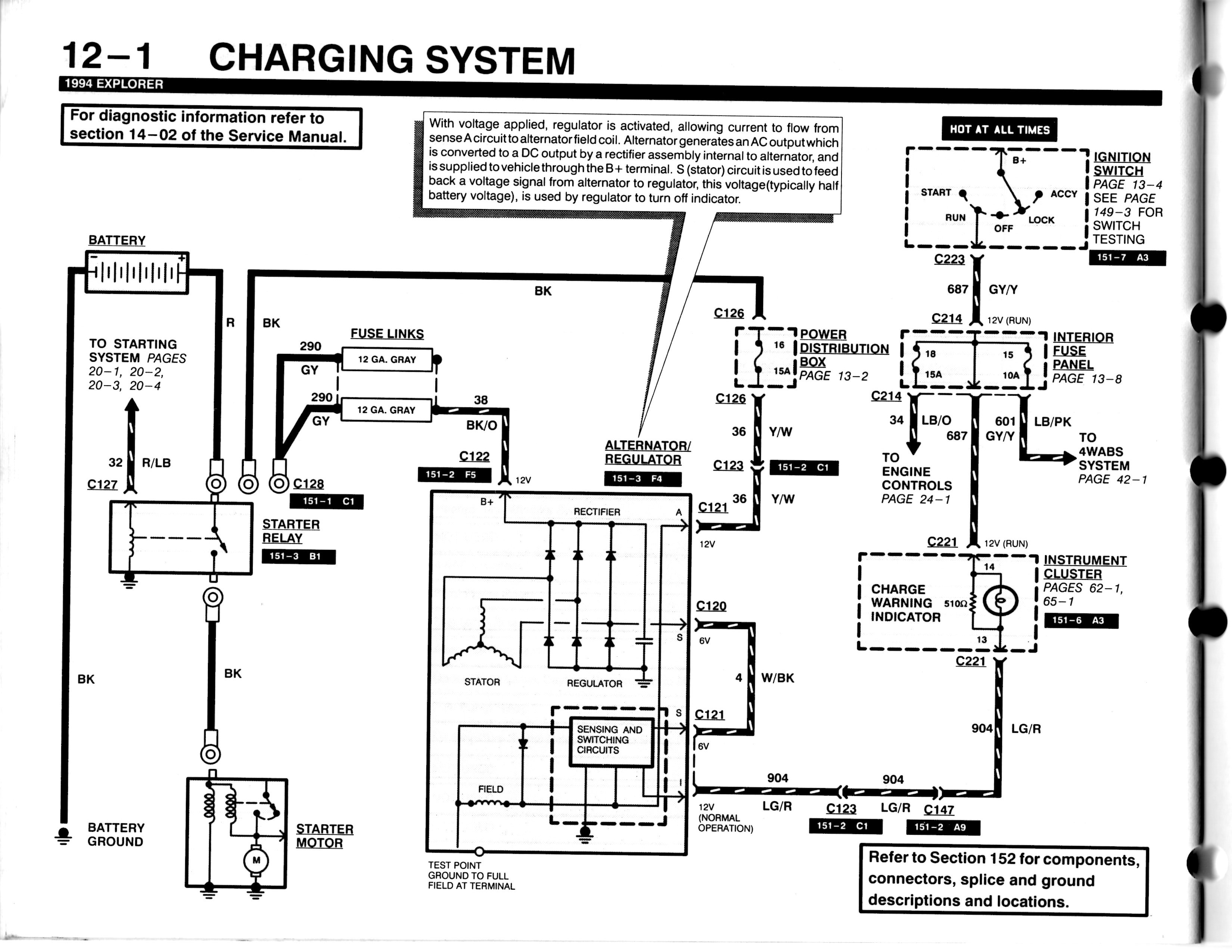

over on the battery terminal of the solenoid, there are two fusible links i think one goes to the alternator what does the other go to?
If I am reading this right, they both do, they seem to be connected in parallel. If anyone grabs this for future reference, be careful, I think there was a revision to this page that I don't have, so use only as a guideline.
