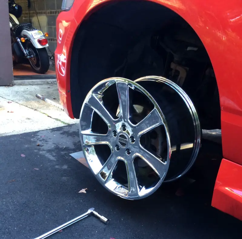

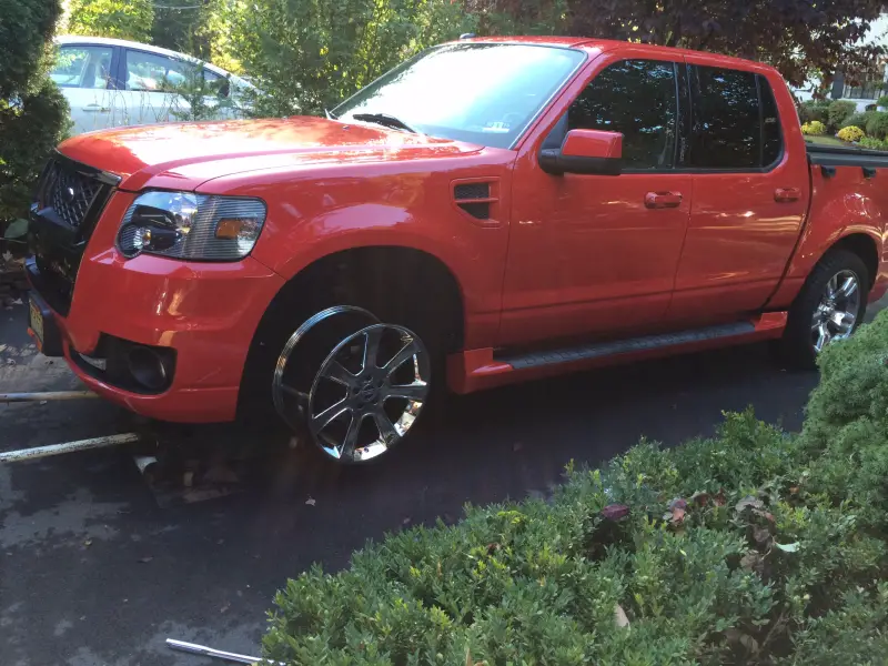

Center bore is actually 70.3.
I recently tried a Saleen S197 replica wheel from American Muscle and at first I thought the 70.3 bore of the AM wheel was to small but after putting the lugs on the wheel it snugged directly up to the hub.
I was concerned it may get stuck but nope. Came right off after I loosened the lugs. I still think they would have looked pretty sweet!
I won't be going with these wheels after all so if anyone is interested I will give you a good deal. I only have 1 so the other 3 would need to be purchased from AM.
The wheel size is 20"x9". Offset Should be a fine fit with the stock 255/50 tires but someone else would need to confirm that.
The tires I have on there are 275/45 Cooper Zeon ltz.
I never got the chance to have the tire mounted to see if the offset would work with the 275's.
