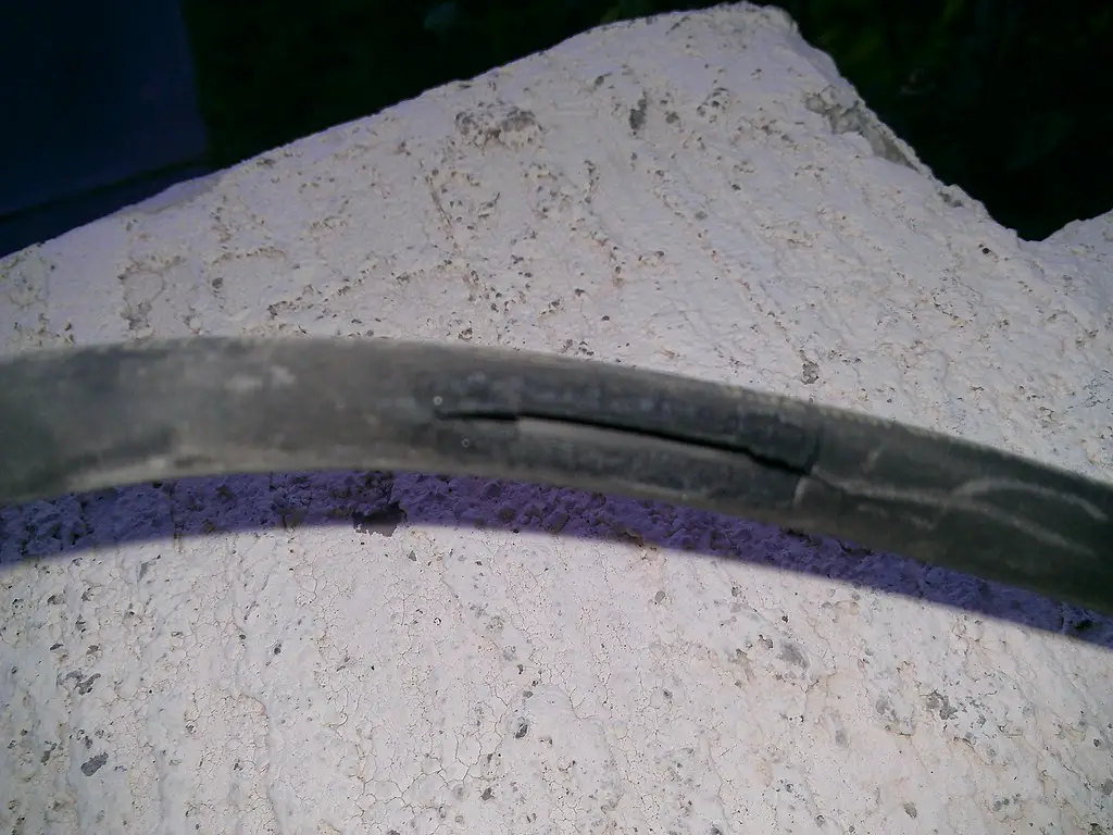

Found it.
This is the Hose between the Canister Purge Valve and the Intake. That was the exact code the car had. Gross leak in Evap system. Thanks guys!!! All fixed.
