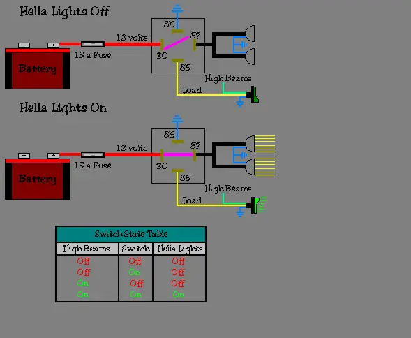

Why use the BCM at all? I would remove the switch from the BCM and wire it directly into a single relay for the lights. Or replace the switch as in the diagram below. IMO 5 relays are way to many and lesson the reliability of the circuit. It would be a PITA to troubleshoot a relay failure (or multiple relay failure). And as Bill has already stated a 14 gauge wire will be fine.

You will need at least one relay, to power the fog lights. But the trigger for that relay can be simple, as just stated above. I don't know what the other three would be for, but it should only take one to capture the odd signal from the BCM.

The setup will work, but the more complexity you introduce the harder it will be to troubleshoot should a problem arise. As for keeping everything factory I am assuming you mean factor "look" as I don't believe the factory used 5 relays to actuate fog lights.
5 relays for fog lights???? Let's all say it together-"Overkill"
