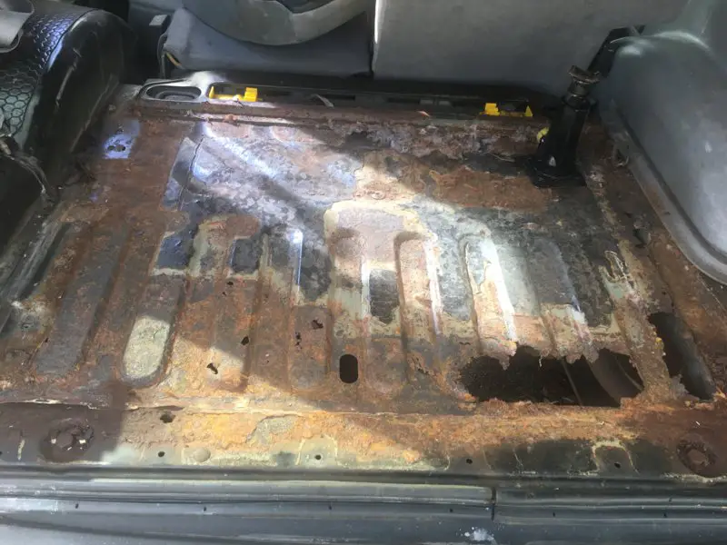

But the thing I hate the worst. Rust. Found the hatch glass was loose and the rear side glass leaks, and the body side moldings. The entire back deck is toast. I hate rust. Mechanical I can get past, but rust... I really have to think on it.

Is there a lot of rust everywhere? or just certain places?
I’m guessing if the floor is rotted, it’s pretty bad everywhere. I’d see if you can stick a screwdriver through the rear of the frame near the shackles.
....and if it isn't it will likely be very soon.
The rust is only on the rear cargo area. The carpet stayed wet so long that it glued itself to the floor.
I'll get a pic next light. And after cleaning it up today I'm not as ugh about it.
But the yards around here do not have many old Explorers any longer.
It’s not too bad. Ha
Get the fork....
Clean. Treat rust. Good primer and paint.
Check your rear cargo area panel glass seals. Probably not in good shape.
Bolt in a section of plywood.
Should be set for years.
Good luck.

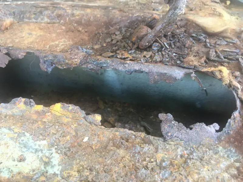

It was absolutely the cargo area glass. Drip Drip Drip.
But you can see the support under the floor is in good shape.
