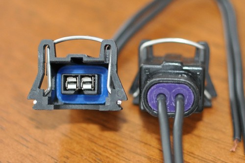

The next problem I have is now I get a P0201 and a P2195. First time for both of the those. Upon unplugging all of the injector relays to remove the rails all of the clips broke and so all I could do was push them on as tight as I could. I am at a loss.

Delphi EV1 connectors
P0201 Injector Circuit Malfunction - Cylinder 1
P2195 Ford - Lack of HO2S-11 Switch Sensor Indicates Lean
Correct the bad electrical connection to the injector.
