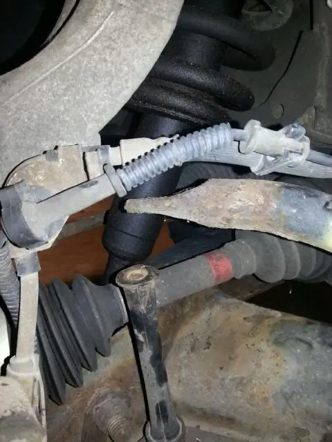

I went to change the front brakes and rotors on my 2002 Explorer Limited and noticed a part was broken. I'm not a mechanic, so I really don't know what this part is called. It looks like it might be an easy fix, and probably torqued on.. but I don't know what it's called so I can order the replacement:
Thanks!

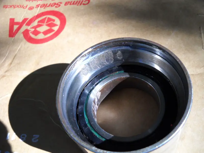

This is my hub bearing torn apart. It was also roaring for a couple thousand miles. We got caught with it starting to make noise while 2000 miles from home. I drove it back home, by then the noise was pretty insistent. Much farther, and the bearing would have crumbled, and then.....well, almost any really bad thing could happen! Don't leave it go too long! imp

End links are probably the single most common front suspension failure. Also check the sway bar frame bushings.
http://www.rockauto.com/catalog/x,carcode,1377660,parttype,7580
http://www.rockauto.com/catalog/moreinfo.php?pk=4202718&cc=1377660]
I just noticed these are slightly different, but the same product. Is there a difference otherwise?
I also just noticed there are different sizes. Is this something I'm supposed to measure? Why would there be varying sizes for a 2002 Ford Explorer? Wouldnt they all be the same?

It's a good thing I have a digital caliper to measure this then! Thank you!

I'm gonna change my driver side sway bar link this weekend, but I don't have time to do the bushing or the passenger side. I need to drive to Chicago on the 25th. So I'll do the other stuff later. I figure since the link is broken, i should fix it before a long drive.
To be clear... do I take the busted one off and put the new one on with the wheels on the ground/jack stands so it's compressed? Do I have to grease the Moog Problem Solver link bushings like I would the sway bar bushings?

On the ground wheels straight. Hardest part is removing the stock links. DON'T over tighten, about 10-15 ft/lbs is adequate.
You don't need to fix it before any long trips, it doesn't even do anything while highway driving. The sway bars keep the vehicle from leaning while going around corners. Mine have been broken for 6000 miles now, I do have new ones in the basement though just waiting for my garage to be finished.
I got it changed no problem, but I think it might be upside down? Plus I tightened it with the truck on the ground, and either the bolt has come loose already, or something shifted. Looks like I have about a 1/2" of play now. I put it on nut side down, and tightened it snug until it was hard to do (my arms were putty by then anyway)
Aftermarket? Probably different from the stock end links and must be the same length on both sides. Change BOTH.
Ok, I can change both. I went with the Moog Problem Solver. And I think it's supposed to go on with the bolt on top. So that means I have it on upside down. I probably only makes a difference in that it's harder to work itself loose if on the top, not the bottom.
