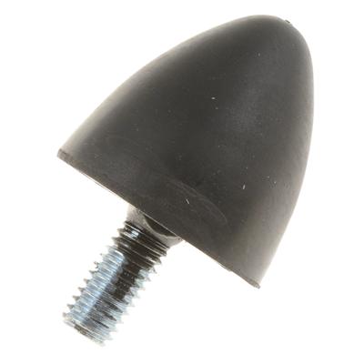

there are lots of names for it.. if you call a ford garage just tell them you need the rubber bumper for the hood. i have a new one in a bag somewhere, ill try to get the pn
I lost those on our X years ago. I got tires of watching the hood rock going down the road (and the noise it made) so I found something to replace it with.
The "Help" section of the auto parts store should have upper control arm bumpstops which has a threaded bolt on it.
The one I'm using is Dorman p/n RNB-31053 (I think thats the dorman number)
I just put them on, then trimmed them down so they were the right height and viola.. new hood bumper/stop/thingamajiger.
Here is a pic I stole from the 'net that is what I'm using.
