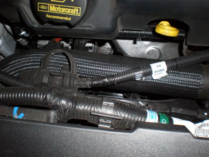

What is this ? Found it in the engine compartment near the fans...a round connector about 20 mm thick...
May be a motor warm up ? Like DEFA warm up ?
On a label I can read: 120 Volt and 10 Amp and 1200 Watt...

Despite there not being any picture that I can see I'm going to guess it may be a plug for the block heater??
Peter
Yes it is a factory Engine block heater. Only really needed when the temp dips below zero for few days. I used mine last year but not this year. It works well. Melted the snow off my hood and engine had heat quickly. Warning is it uses a lot of juice and you will see it on the bill. Also Mice like warm places to nest and will build a nest in a couple hours. Somehow they sense the heat.
