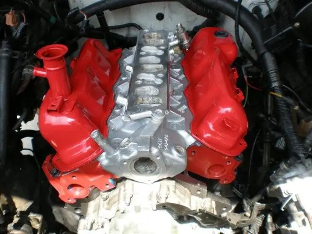

I'm leaking coolant from where the thermostat mounts.
I want to call it the top of the engine block. If you stick your finger down below and to the right of the thermostat mounts, that is where the pin hole is. Basically straight through the coolant temperature sensor (I guess that is what it is.)
I'm driving a 1999 - 4.0 OHV.
I may be wrong (never had a 4.0L OHV) but I think that's part of the timing cover.
Believe it or not, that whole cast aluminum assembly is the lower intake manifold.
Unless, you mean what is behind & underneath that, in which case I would agree with koda2000.
Take a look and let us know...
Here is a pic of the lower intake and front of the engine... Can you point out where the coolant is coming from???

Basically I have to stick my finger along side the lower intake, on the driver's side, as far as my finger can reach. It is on the side, and towards the bottom of what I can reach.
I took the thermostat out, and tried to feel for something from the inside, and was unsuccessful. It must be a hairline crack or pin hole. Anyone have a creative way of JB welding something like this rather than replacing the intake? I am in the process of shopping for a replacement car, I just need a couple more weeks to find the one I want :)

For those following, I applied JB Weld today. I used the original cold weld and smeared it inside the thermostat hole, and then use steel stick on the outside, and hence coated the steel stick with cold weld. I will update you tomorrow afternoon if it holds.
JB Weld seems to be holding. I used both the original 2 part epoxy on the inside, and then the SteelStik on the outside, and then covered the SteelStik with the 2 part epoxy
