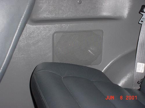

what do i have to do to my doors to mount 6.5 in components, i dont want kick panels, i want this sucker looking stock, i know it can be done, any help is appreciated

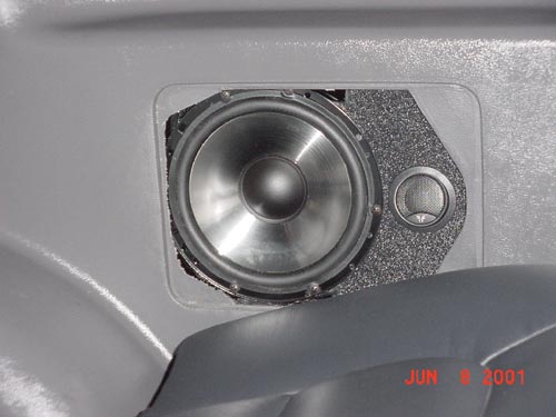

Well you will basically just have to make some wooden plates to mount them in, thats all, easy. Your choice, you can mount just the 6.5" woofer in the factoryspot and mount the tweeter elsewhere, or you can mount the tweeter right next to the woofer.

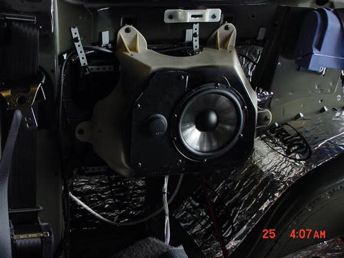

If you want to keep it stock you are going to have to make adaptor plates. When I do this for really good customers or friends I build them out of aluminum instead of wood.

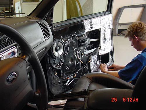

Below is the front 6.5" set
Below is the rear 6.5" set
looks great, just curious, but how did you wire those?
i meant through the doors, did you just push the wire through (looks like a pain), use stock wiring, did i clear it up a bit?
thanks man, any hints on how to get it through the doors?

liquidx9 We just use a fish tape or cut a wire coat hanger just take your time.

It just like making them out of wood. Get some 1/4 aluminum from a metal supplier and make sure you have a jig saw with a couple of sharp blades. When I make them I place the factory speaker face down and I trace out the shape or factory speaker on to the metal, mark the mounting holes from the factory speaker and drill them out. I next take the template that come with the new speakers and line them up as much as possible inside the trace of the factory speaker. You might be out side the trace but thats fine. I then cut out the speaker openings with the right size hole saws. I will then cut the adaptor out making sure it is large enough for the new speakers You might cut it bigger than what you traced fron the factory speaker.

liquidx9, on my 91, there is a rubber boot betweent eh door and the body that can come off, well out of each side then u can use a coat hanger or fish tape like black magic was talking about.
By the way black magic, did u have to remove ur dash to get to the hole in the door jamb to run te wires, or do you know what i would need to do on a 91? cant figure out how to get wire my fronts because of that.
