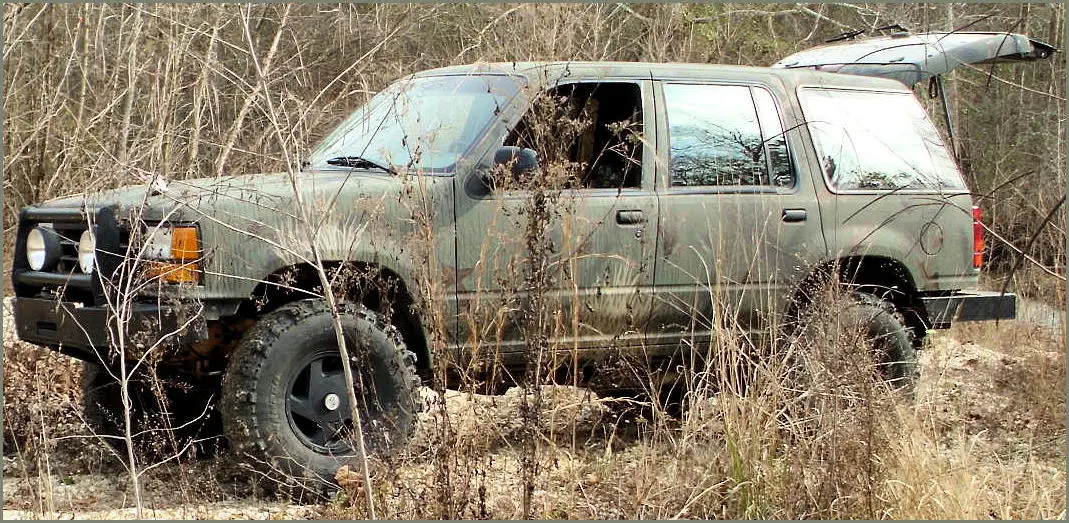

What size tires?
33x11.5x15 on stock narrow wheels. There are as tall as the 35 11 boggers I had in the pic.
