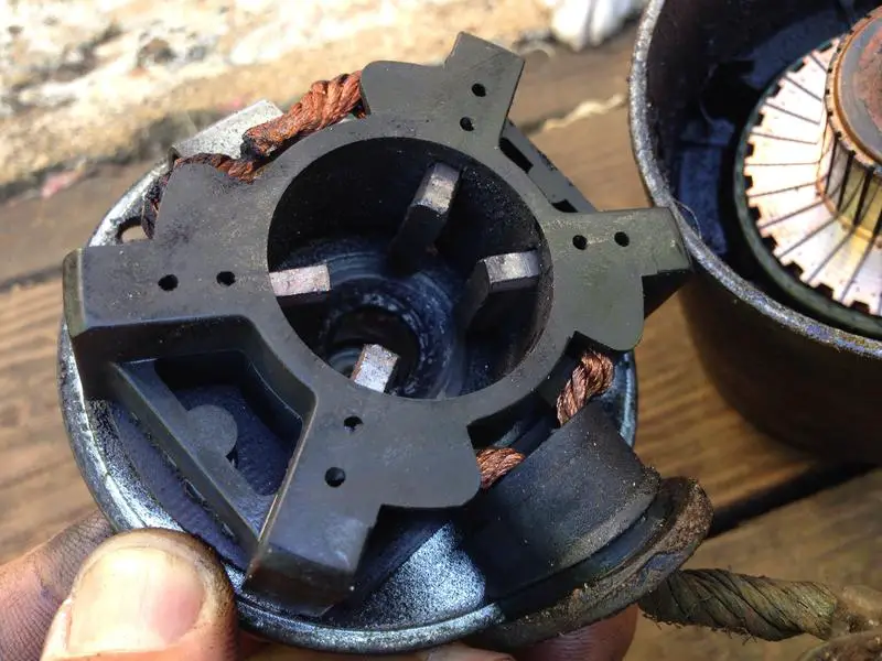

I opened up the starter again just now, it doesn't seem as oily as my first impression. I did disassemble it further than before, and found what i believe are the brushes.
Anime's comment about bad brushes being so far worn down makes me think these are not worn much, assuming these are the brushes! Electric motors are not my strong suit.
Also, to get this piece separated from the starter end cap, I need to remove two small bolts, smaller than the long bolts that run straight through the starter. The long bolts take a 5/16 socket, but on the small ones, 1/4" is too big and 7/32 is too small. What the hell is in between!? Maybe it's metric, but I don't have metric that tiny...

Those brushes aren't worn much, they stick into the center plenty and so have lots of starts left to go.
6mm is between 7/32" (5.55mm) and 1/4" (6.35mm).
You should really get a metric set of any sockets you don't already have, especially 1/4" drive for taking apart smaller stuff. Most stuff on vehicles is metric.
6mm, thanks! I have that in a box wrench. I looks to me like I need that end cap/cover off to get the brushes around the copper piece when I reassemble.

You'll probably need to take the end cap off. It's tricky to get all four brushes pushed back to slip it over the armature without the plastic ring made for the job (it comes with some aftermarket brush assemblies to make the install easy), but you can do it if you hold the brushes back using two fingers from each hand on either side, holding the brushes back with a fingertip on only half the brush, letting the other half clamp onto the armature, then just slide it on the rest of the way. Either that or find a plastic cap or wooden dowel the same diameter as the inner part of the brush assembly, use that to hold the brushes back, slip it over the armature, and slowly slide it back to let the brushes click against the armature, but without messing them up. They are pretty soft and will chunk or lose material if scrubbed with something rough. They'll still work ok, but every tiny bit of material they lose is less electrical contact and less electricity getting to the starter, so less torque.
Before you put the starter back together though, look at it and make sure all the magnets (the curved black things inside the metal housing and around the inner copper armature) are stuck on there good. The magnets should not move and should not have any cracks, or otherwise be damaged. If there's any damage to anything inside the starter, that will prevent it from spinning and so the solenoid will just click but the starter can't use the electrical energy to do anything if it's stuck, or at the very least will be noisy after awhile of starting with loose parts inside.
