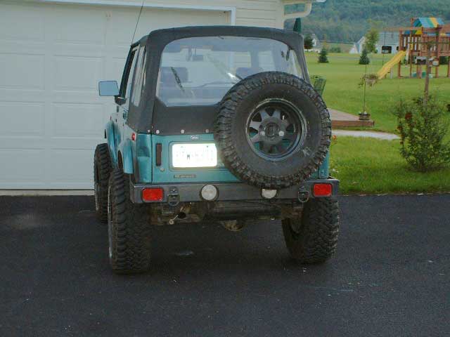

Ithought about doing that with my rear bumper after I had already cut out the light holes :fire: ! Maybe one of these days I'll go get Heep taillights and make a new rear bumper with an air fitting on it. BTW, here's my rear bumper. Made out of 3" x 6" x 1/4 wall box tubing. The ends are 1/4" steel plate.
