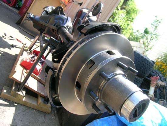

I'm running A Wagoneer D-44 converted to 8-lug using Chevy stuff (rotor, backing plate and caliper only as the Wagoneer's D-44's spindles and bearing dimensions match the Chevy 8-lug's) . I did it to match the lug pattern of the 14-bolt rear (aka "boat anchor").
But as for the weight question, the biggest difference is in the rotor and hub (I bought them as one unit -- cheaper that way). The 8-lug rotor is not only wider, but thicker. Oh yeah and I think the backing plates were a lot thicker on the 8-lug too -- you can kind of see this in the pic above, probably about 3/16" thick stamped at least.
