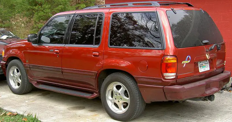

This is the only picture I find handy to show the first tires I put on my Mercury. These are 255/60/17's, with a 1/4" spacer(30mm offset 17x8" wheels(which makes them about 24mm offset(1/4" is 6.35mm))). I had the truck lowered then with the Explorer Express kit, 2 38" rear lowering blocks and front bump stops from a Limited. I lowered it slightly more when I wore those tires out, but it's still very close to that. If you go much lower or bigger with tires etc, you get closer to rubbing. I had none with those first tires, but went to a 265/60/18 next, and worked my way down from there. Now it has 255/55/18's which are 29" tall like the stock 15's and the 17's were.
I would suggest the size range near a 275/55/18 as a limit(that's a 30" tire) with less lowering than with a 29" tire. I was hunting a wheel that was either 17x9" or 18x9", and found two of the 17's first. I was after a particular wheel, so there are lots to choose from, the offset is the big key when you push the tire sizes and lowering.
