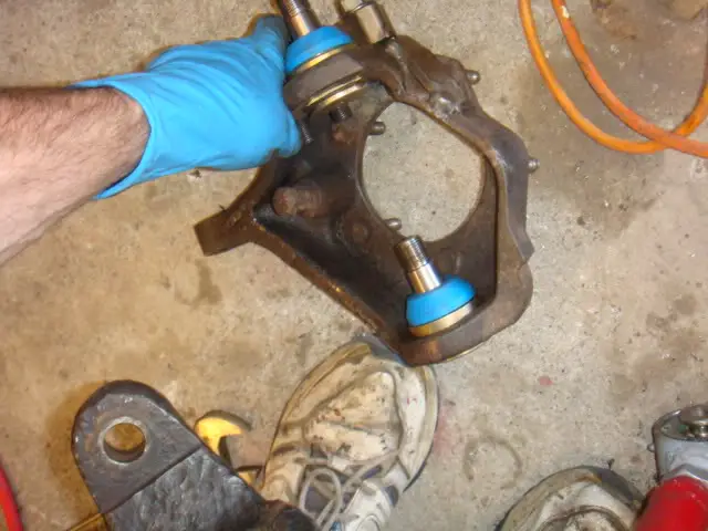

Moog has gone to hot forging where as McQway Norris top of the line is cold forging which is way better. Napa's top of the line which have the blue top is also cold forged, which if I remember is made by McQay Norris's but under their name. Years ago Moog used to be cold forged. On my solid I used Napa's top line ends.
Here's a pic of the blue ones by Napa which are cold forging. This is on my modified flat top Dana 44 knuckle.
The blue napa ones are raybestos which is the new spicer.moog has gone down hill.
The blue napa ones are raybestes which is the new spicer.moog has gone down hill.
More specifically, Raybestos Pro. grade. And I agree, Moog isn't what is used to be.. Raybestors Pro and Spicer are the only ball joints that last any amount of time in our X.

Doesnt raybestos owns spicer now? I heard that moog is being made overseas now and that's why its gone down hill.the rabestos pro are beefy well made stuff

I spent the few extra bucks and went with the Raybestos Pros on mine after a lot of reading. Not a job I want to do over and over again.
AFAIK, yes.. its the same company now but you can sometimes still find Spicer brand balljoints.
