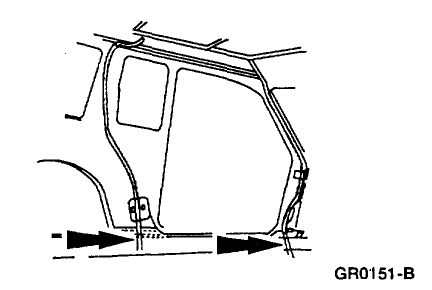

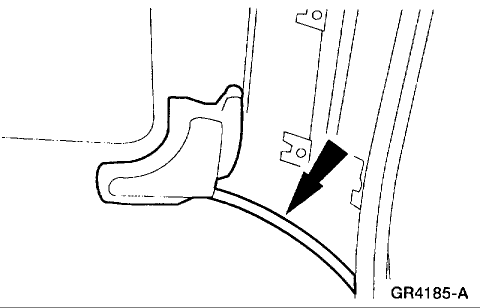

The lines don't actually exit out the bottom. In the front they stop inside the inner fender, and the rear stop down in the lower rocker panel in front of the wheel well. You can't see them up top because the "drain tray" or whatever the correct name is about 4-5" deep at the corners where the drains are. By deep I mean 4-5" out from the opening towards the pillars. Unfortunately I think you're going to have to take down the headliner, I don't know of any other way. Maybe someone else knows some trick or shortcut. The spot where the drain tube attaches is where you can use compressed air to blow down the tube as well as back up to the moon roof drain hole area.

thanks albi1cnobi1. that's what i needed to know. i've been doing some Google'ing and it seems dropping the headliner isn't that hard to do, just trying to avoid it if at all possible. guess not. once it's outta my way it looks like blowing or fishing the drain lines will be easy enough.
