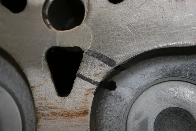

Here are some pictures of some of the cracks on the last set of heads before I got rebuilt ones.
4.0-head-cracks-93tms 003 by maniak_az, on Flickr
4.0-head-cracks-93tms 011 by maniak_az, on Flickr
4.0-head-cracks-93tms 007 by maniak_az, on Flickr
4.0-head-cracks-93tms 009 by maniak_az, on Flickr
4.0-head-cracks-93tms 001 by maniak_az, on Flickr
The head that I got last time that was bad from the rebuilder was cracked on the top, on one of the humps...

Maniak -- Nice photos. I have never seen that side of a head personally, but those helped. Thank you. But is there a particular cylinder that this happens to? #1 , between 1&2, #2 , between 2 &3, #3 . Same for the other side with 4,5,6?? At this point just curious which cylinder or water port is the bad one. OR is it so random that it can be any one of the 6?
From what I remember from my research when we cracked the first set of heads, it's the passenger side, towards the rear that seems to crack BUT from what I've personally seen, it doesn't really have a pattern..
They crack between the valves, between the water jackets and IIRC the 93tm heads have a thicker casting on the humps so that must have been what ford thought what an issue.
