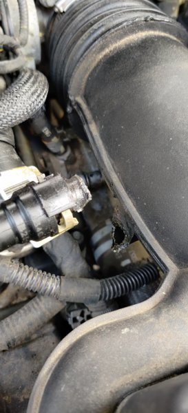

Found two more issues.
1) they broke the vacuum tube connector coming off of the intake, looks like they tried to crazy glue it, but it didn't hold.
2) they didn't put the bumper back on tightly... And didn't fasten a portion of the underside wheel well and under bumper shields.
Ugh.View attachment 178348
When I bought my used explorer that nipple was also broken off, They used the cap from a BIC pen to try and reconnect them. Ended up replacing the whole tube for $45ish.
