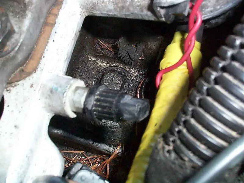

Ok, Ok, I found it! Sure enough the vacuum line was off.
fpr
:thumbsup: heheh was just gonna put a picture up to show u were fpr is ive had that line come off on me also took some light gauge wire an tied it so it will not come off agian:salute: an a piece of bright tape so i can see the end of it better

I now have it tie strapped! Each end, 1 at the vacuum tree and a pair at the FPR (Each side of the rubber grommet on FPR). I think all that ATF from the former bad tranny modulator causes them to get loose.
