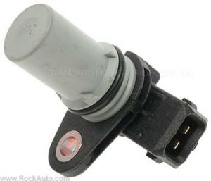

Rock Auto's site is usually pretty good but it is wrong in that 97 Ex listing. The 4.0 SOHC CMP sensor looks similar to this:

^yup thats the one :)^
