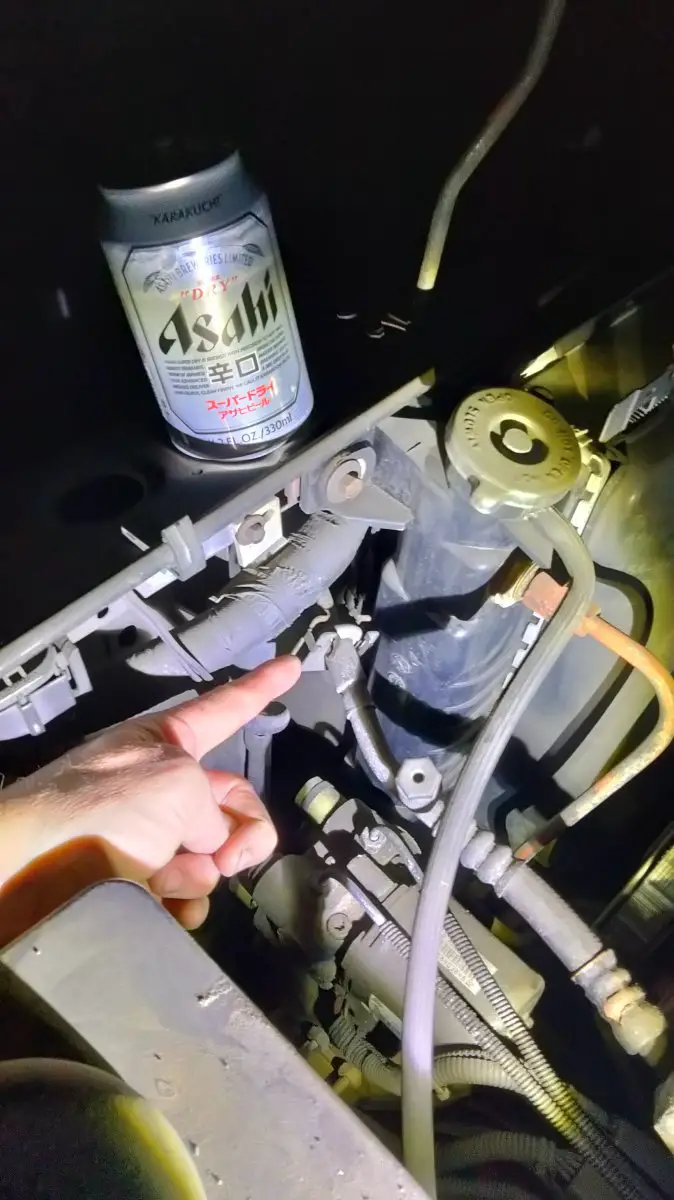

The other day I changed the radiator, and found this loose part.
I hadn't seen it before and I don't know where it goes.
Can someone give me a clue or upload a photo of where it goes and what function it performs? Thanks for the help!!
That is a safety clip for one of the quick disconnect fittings under hood. Could be fuel line or ac line. Look fuel lines over, you should see one attached to show how it goes back on
Thanks Turdle.
AC compressor was removed bt the previous owner, so all the lines are "hanging" in the engine compartment......may be is one related to AC?
I agree, A/C line safety clip. Fuel clips are a little different shape/longer
Hi Brian, thanks
someone can upload a video or picture to see how to attach it and were?
I don't know which line should be set where and at what point.
